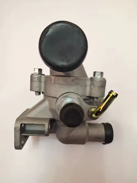

I was just browsing the interwebs and came across the following thermostat assembly which seems to be maybe serviceable and should fit the 2.8CRD:
It can be found by looking for "MAXUS V80 Thermostat" on Aliexpress and costs around 70$ shipped or less depending on where you live.
Maybe this could help out someone.

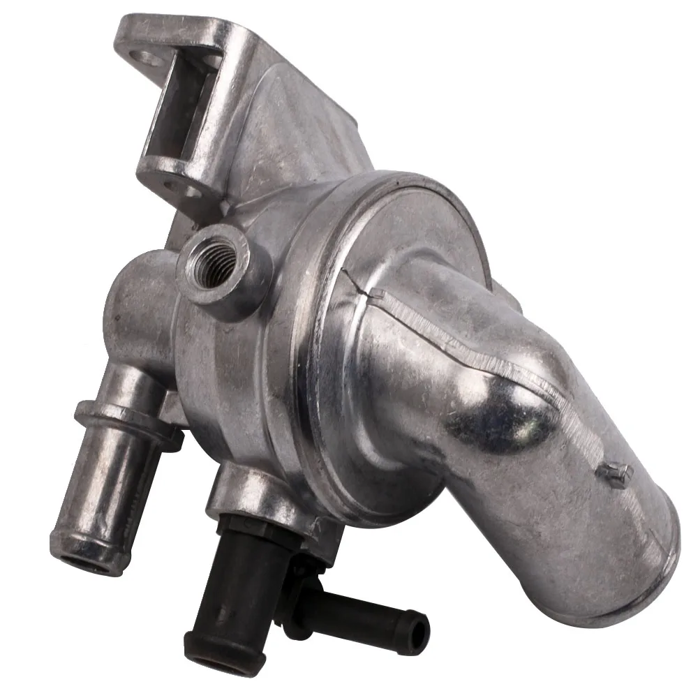

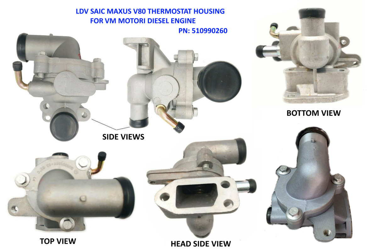

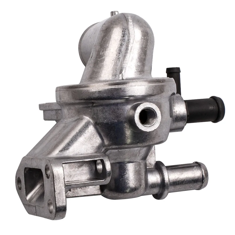

Found a few more images of it online posted below. Looks to be plenty of them available in England for around $100 with shipping according to some of the ads I found.

When you google the PN: 510990260 for the thermostat in question, most of the hits that are found are in England with a few being in Europe. :google:

Yeah, upon further inspection it looks like it is not just a bolt on item that would work right out of the box since the engine in the Maxus v80 is oriented differently than in the Jeep.
However, I feel like with a bit of effort it might be able to work if the thermostat top cover was clocked differently (can only clock it ~close to what the Jeep one should be and will not be the exact same angle) and if the other hose connections were mounted in the other face (will require drilling and tapping).
