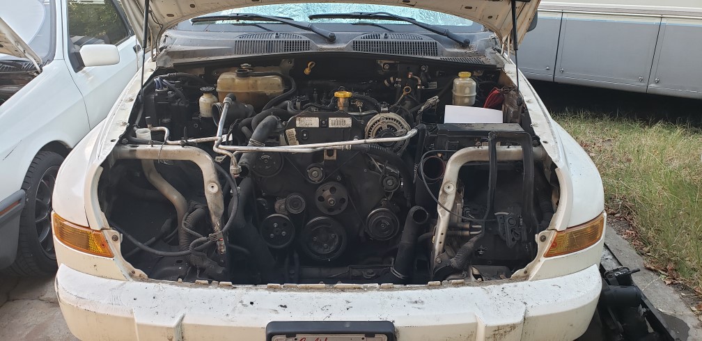

I bought this CRD a few years ago, put a huge amount of time & work into it, and then before I really even got to drive it anywhere it developed a massive oil leak from the back of the motor. Months spent diagnosing lead nowhere, my best theory is that a plug on the back of the block or head is leaking. And not a small amount. A lot.
So I parked it, and I just haven't had the budget or willpower to get back to it... until now.
Over the weekend I did a leak down test to ensure there weren't any internal problems. That came back VERY clean, so at least I don't have to deal with any of that. My basic plan is to fix the leak, replace the head gasket, and replace the timing belt... I'm sure I will find other things along the way, but most everything that's not internal to the motor was addressed when I got it... motor mounts, transmission (torque converter, fluid pump), glow plugs, EGR, updated filter head, etc.
It'll be slow going as my October is packed, but I made good progress last night:
I'm following the FSM which is not entirely accurate... but so far I don't think it's lead me too far astray. ;) During my troubleshooting I added dye to the oil, so I'm hoping to find traces of that to lead me to the actual problem I'm trying to solve.
I think I may be able to have the motor out by the end of the week... then it's figure out what I need to order and then sit on my thumbs til it shows up. :)

Friendly advice: :D
Since your going to that much trouble and effort, you should replace all the exhaust valves.
If you don't and you put it all together and a few hundred or thousand miles down the road it drops (breaks) an exhaust valve and destroys the engine, you won't be a happy camper!
There have been quite a few LOST members who have reported having an exhaust valve break off when getting close to the 200k mark.
At a minimum it will destroy the head and possibly a piston rendering them both unusable.
And if and when this happens; in a few cases it has totally destroyed their whole engine to the point it is no longer usable and the complete engine had to be replaced.:grim:
Replacing all exhaust valves with new ones at this conjuncture with your engine out to repair an oil leak and while the head is removed is some awfully cheap insurance...

Sounds like solid advice.
Are there any tell-tale signs of impending failure? It would seem like there should be some indication of that before it actually happens. I will have a trusted machine shop go over the head prior to reinstalling no matter what... if there is something they can look for rather than just pre-emptively replacing valves I'd like to explore the possibility.
Edit: NM... I did not realize they're only $20ea. Last time I had to replace valves on a 4v/cyl head they were … a lot more.

I'm at 180k. The thing runs GREAT - if not for the oil leak I wouldn't even be doing this. When I bought it, I thought it was a very solid purchase, miles notwithstanding, as it was super tight. I didn't realize the skid plates were literally covered with rock and dirt and absorbing all the oil that was leaking. Once I cleaned them, that oil was free to dump onto the ground... and then I parked it.
I'll check out the rockers when I pull the head and see what I see. I'd like to not spend that $400 if possible.. that's a really big number to add on top. I think I will go ahead and order the valves and valve stem seals so I have them for the machine shop (so they can get going as soon as the head is off)... save everything else (including rockers) for a second pass.
I guess worth mentioning is that I will probably only keep the CRD for another year or two, which represents maybe 8,000 miles of driving. Not that I wanna stick the next owner with broken rockers, but the $ per mile ratio already sucks. ;)

I made some good progress last night and am just about ready to pull the motor... I should be able to do it this weekend.
Where is the best place to attach an engine hoist? I have a balance bar, but there isn't much on the top of the motor to attach hooks or chains. I have some screw-in eyelets as well, but I'm not really seeing any good spots to install them. The camiforld is confounding!

Really appreciate the feedback.
geordi wrote:
Leave the AC system alone if you haven't already wasted it - you don't need to vent it to remove the motor, the compressor can be left in the engine bay fully connected.
The previous owner had some work done by a shadetree mechanic... it's so long ago I don't remember what it was, but the Jeep came to me with non-functioning AC as it had already been purged. Since it's been sitting in an unknown condition for 3+ years, I'd just assume start from a known state. Plus, this is Sacramento... temps are 100+ for months on end. Top notch AC is a must. (Not for me, half my cars don't have AC, but when it comes time to sell)
There is no "flex plate cover" it is either the engine-side housing or the transmission.
The FSM references such a thing, but I didn't find one. But, it looks like there should be a little cover over the flex plate access above the starter. It looks like there are three or four tapped holes. I found it *really* odd that any OE would leave such a hole uncovered and assumed a previous mechanic lost or forgot it. Are you sure there is nothing back there?
You definitely want the ARP studs, the leaking head gasket problem is from the factory BOLTS not from any other source.
The factory bolts got this CRD to 180k... I understand statistically they may not last forever, but the real future for this Jeep is another five or eight years and another 50-80k. After that it'll be 20 years old and fodder for a Pick & Pull. I'm reasonably confident new factory bolts will offer that service. I'm not 100% sold on this plan - ARP is still under consideration - but if the point of ARP is to get this thing to 2030... it's just not worth it.
As for the other stuff, I'm not going to pass on a $30 part (hoses, seals, etc.) and have to take stuff apart later to deal with a failure. I'll deal with everything I have reasonable access to now and have confidence of several years without having to take a wrench to it. I've been pretty successful driving old cars using this approach... and at 180,000 miles this Jeep is the *lowest mileage car* I daily!
Sounds like you are well on your way with skill, good luck!
I hope so. I'm learning about Jeeps and turbodiesels at the same time. ;) I've got a lot of time building European cars, and turbo gasoline cars, and lots of turbo gasoline cars... but the CRD is first. :D

Ok, so what you are calling a flex plate cover... Is just a semi-rectangular rubber plug. If it isn't there, then it is no big deal. That is how the bolts in the flex plate (four of them) are accessed, but otherwise there's nothing major going on in that area.
I understand about the heat, all my vehicles MUST have A/C, no exceptions. If yours is already purged / unknown, then might as well fix it. I was suggesting you didn't need to mess with it just to pull the motor if the system was good, which it obviously isn't.

Got the motor out today, and now I am left with a bunch of questions. I had hoped to find clear evidence of the source of the leak, but no such luck. The dye I'd added shows nowhere, and there is so much oil in so many places a leak path isn't apparent. The only thing I can really suspect is the head gasket.
I took this video … maybe there's something in it I've overlooked:
https://youtu.be/016u1t8CYoM

Bad deal not to find obvious source of leak after all that work, I feel for you been there couple of times now but it is better than finding terrible news like an obviously cracked block in an area that would be difficult or impossible to repair. Hope its not the head itself. At least if you do not find it you could thoroughly clean the whole engine while out and you could put on engine stand and with a harness etc you could run it on the stand and observe but this would be a big headache though maybe not as much of a headache as reinstalling it and then finding the leak! Hard to believe with a huge leak the dye didn't show anything.
On another note , where did you end up attaching to firewall side of engine to pull it ?
Just another general idea. Its possible using a temporary electric oil pump might pressurize at least part of the system enough to see evidence of a big leak and you could even hook up starter and turn engine over some to aide in this . The glow plugs and or injectors could also be pulled to lessen work on the starter if nothing shows initially from head gasket.
