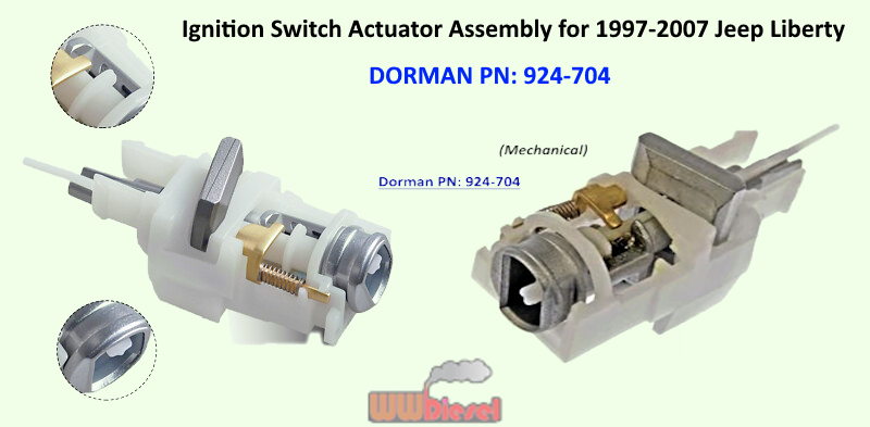

This is probably what you need, they are known for going bad (breaking).
You can search LOST for instructions on how to replace it. I believe it is quite easy to replace.
Ignition Switch Actuator Pin 924-704

The problem is most likely the actuator rod for the ignition switch. They are notorious for failing.
Autozone: Ignition Actuator; #295435 924-704 DORMAN
Dorman Ignition Switch Actuator Pin 924-704
Watch this very good YouTube video by Eric O where he walks you through every step of replacing the defective part. :D
https://www.youtube.com/watch?v=PwbEmSCX8kM&t=1002s

As with others above, the problem for my little tractor was the actuator assembly (the metal “tips” were broken off). I can’t complain, because it did last for 20 years and thousands of starts. After reading the info here and watching a couple of YouTube videos, it took me about 30 minutes to fix it. I’ll keep a spare in the back from now on…
