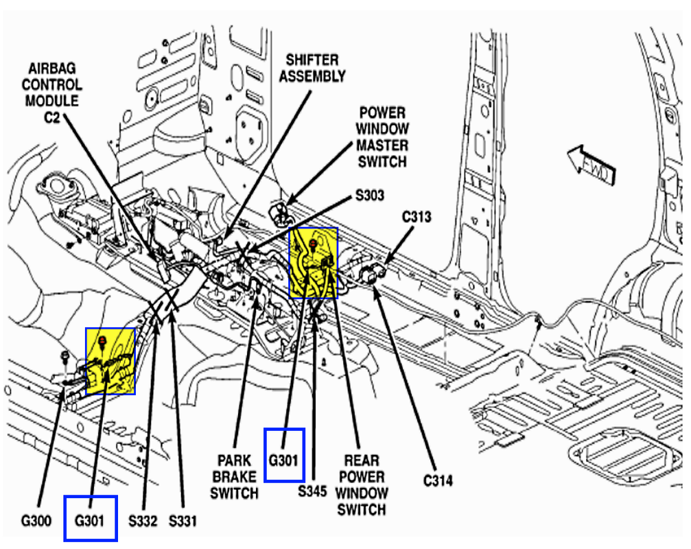

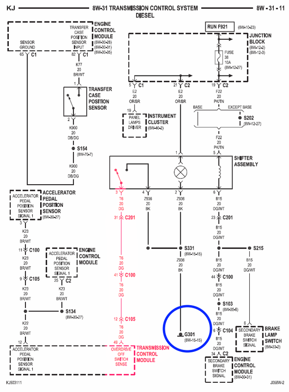

The FSM shows the OD lockout is controled by the TCM via the button on the side of the gearshift.
IF the TCM is not happy with all the inputs, it may be keeping it from operating properly.
Be sure and check the grounds (G301), FSM shows two of them in the shifter area.
See wiring diagrams and ground location drawing below.
From the FSM:
TRANSMISSION SHIFTER OVERDRIVE SWITCH wrote:
OPERATION
At key-on, fourth gear operation is allowed. Pressing the switch once causes the overdrive OFF mode to be entered and the overdrive OFF switch lamp to be illuminated. Pressing the switch, a second time causes normal overdrive operation to be restored and the overdrive lamp to be turned off. The overdrive OFF mode defaults to ON after the ignition switch is cycled OFF and ON. The normal position for the control switch is the ON position. The switch must be in this position to energize the solenoids and allow upshifts to fourth gear. The control switch indicator light illuminates only when the overdrive switch is turned to the OFF position, or when illuminated by the transmission control module.
G301 GROUNDS
