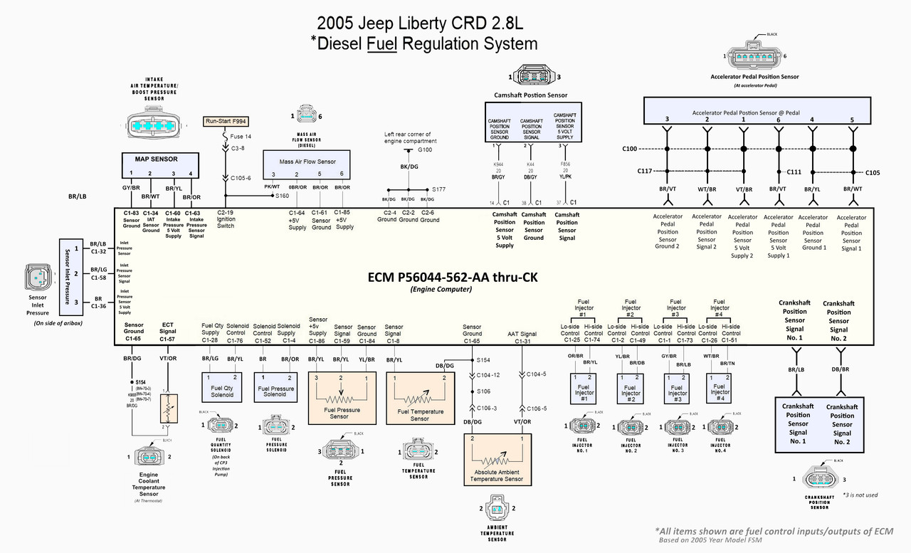

The codes you listed:
P0090 -- Fuel Quantity (metering) solenoid – open circuit Wiring open circuit, Fuel Quantity (metering) solenoid, ECM
P2294 -- Fuel Pressure Regulator 2 Control Circuit Open
Which sensors have you tested and and what was the voltage you reading at each one.
Post and maybe we can help you by looking at the wiring diagrams.
Post year model:
Sensor (name) voltage readings on each legs, (No. of wires & wiring color codes) connected or disconnected when testing.
This drawing may be of help?

According to what I have on file, both solenoids in question are supplied 12v from the ECM and are controlled by the ground side wire from the ECM via a pulse width modulation signal.

If the one leg of the "Solenoid Fuel Pressure" and of the "Solenoid Fuel Quantity Solenoid" are "Pulse Width Modulation" as WWDiesel states then you need to place an Oscilloscope there to see what is going on! Using a Digital Meter there is meaningless! :shock:
So looking at wiring Diagram 8W-30-14 these "control " wires would appear to be the Brown wire from C1 Pin 52 and the Brown/Yellow Stripe wire from C1 pin 76.
You could try spraying some Contact Cleaner on these contacts at the ECM and the C1 Connector...the contacts on the connector and the ECM are very delicate....the Dealers use an Extender Block fitted between the Connector and the ECM so as to be able to get their instruments into those positions without damaging the contacts.
You can try unplugging the C1 connector...with battery disconnected.....and measure with your Ohm meter from the pins at the two relevant solenoids to ground....should be no continuity to ground if the C1 plug is disconnected!

Check the ECM Ground is clean and tight...the Black/Dark Green wires going to G100 as shown on the diagram.
