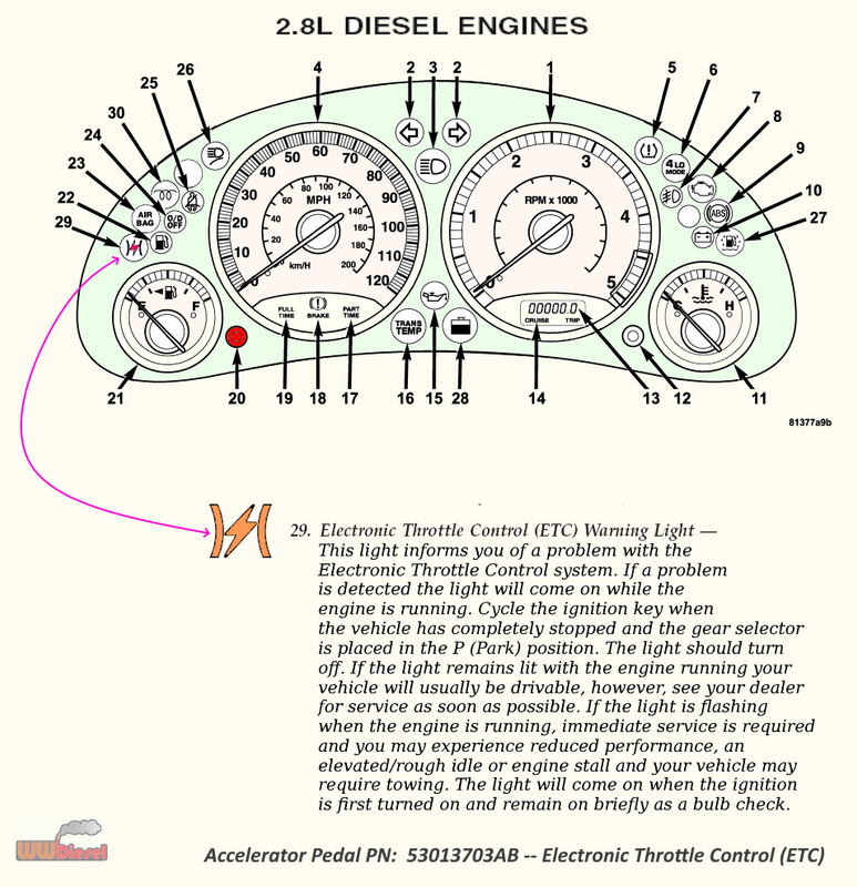

More information on the ETC WARNING LIGHT on the Instrument Cluster.
(It is not something a driver should ignore)
(ETC) Electronic Throttle Control Indicator
• Bulb Test - Each time the ignition switch is turned to the ON position the ETC indicator is illuminated for about fifteen seconds. The entire bulb test is a function of the ECM. (Electronic Control Module)
• ETC Lamp-On Message - Each time the cluster receives a lamp-on message from the ECM, the ETC indicator will be illuminated. The indicator can be flashed on and off, or illuminated solid, as dictated by the ECM message. The indicator remains illuminated solid or continues to flash for about twelve seconds or until the cluster receives a lamp-off message from the ECM, whichever is longer. If the indicator is illuminated solid with the engine running the vehicle will usually remain drivable. If the indicator is flashing with the engine running the vehicle may require towing. A flashing indicator means the ETC system requires immediate service.
• Communication Error - If the cluster receives no lamp-on or lamp-off message from the ECM for twenty consecutive seconds, the MIL is illuminated by the instrument cluster. The indicator remains controlled and illuminated by the cluster until a valid lamp-on or lamp-off message is received from the ECM.
• Actuator Test - Each time the cluster is put through the actuator test, the ETC indicator will be turned on, then off again during the bulb check portion of the test to confirm the functionality of the LED and the cluster control circuitry. The actuator test illumination of the ETC indicator is a function of the ECM. The ECM continually monitors the ETC system circuits and sensors to decide whether the system is in good operating condition. The ECM then sends the proper lamp-on or lamp-off messages to the instrument cluster. If the ECM sends a lamp-on message after the bulb test, it indicates that the ECM has detected an ETC system malfunction and/or that the ETC system is inoperative. The ECM will store a Diagnostic Trouble Code (DTC) for any malfunction it detects. Each time the ETC indicator fails to illuminate due to an open or short in the cluster ETC indicator circuit, the cluster sends a message notifying the ECM of the condition, then the instrument cluster and the ECM will each store a DTC. For proper diagnosis of the ETC system, the ECM, the PCI data bus, or the electronic message inputs to the instrument cluster that control the ETC indicator, a diagnostic scan tool is required. Refer to the appropriate diagnostic information.
P0698 -- Accelerator Pedal Position Sensor Supply Voltage Too Low
