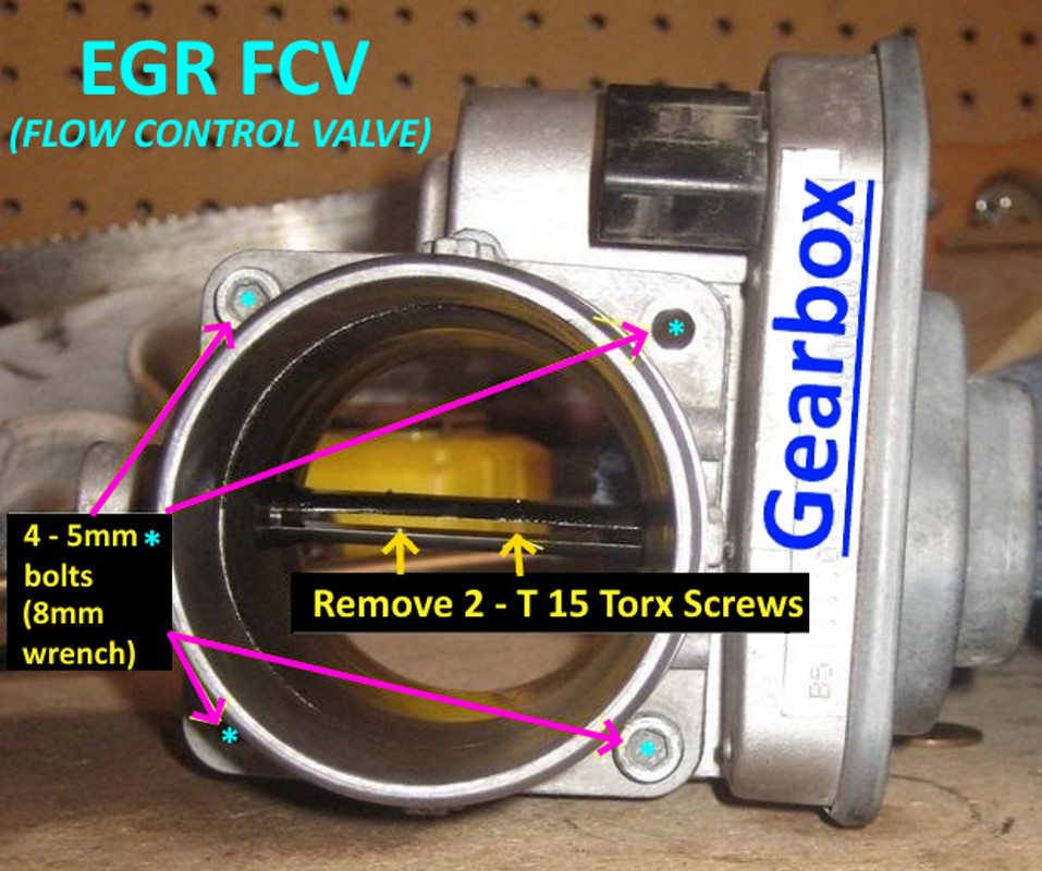

    3. Failed FCV will stick partly closed and can severely limit air flow and boost into the intake manifold. The small gears in the operator for the FCV are notorious for failing and sticking.
    You can remove the butterfly plate out of the FCV very easily. There are only two small torx screws holding it to the shaft. Removing it only takes about 15-20 minutes. See picture.

Unplugging the FCV will prevent its operation, but it won't prevent it from sticking partly closed or its small gears in it operator from hanging up.
Only by removing the butterfly plate out of the FCV can you assure full disablement of its issues.
As to removing the butterfly plate, it is best to partly disassemble the valve assembly to easily get at the two small torx screws holding the butterfly plate to the shaft.
Once you remove the two torx screws, simply slide the butterfly plate out of the shaft, then reassemble the valve. see picture
