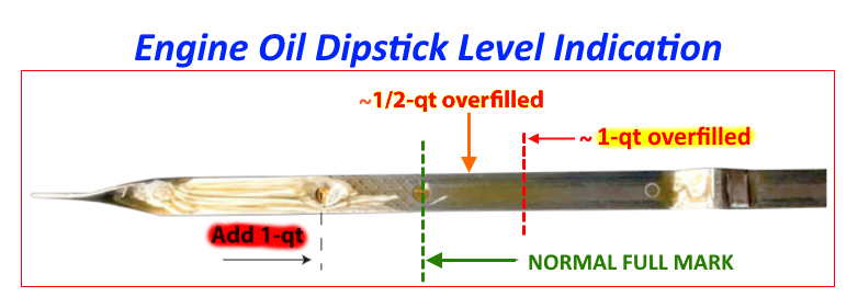

Are you loosing any engine oil level?
If it is being sucked out by the turbo or if the exhaust side turbo seal is leaking, you should see a decrease in in engine oil level.
Be careful, there have been a few reports of the turbo sucking ALL the oil out of the engine causing bearing failures.
Also, if the suction side turbo seal starts leaking bad enough, it could cause the engine to have what is called an "engine runaway" which is an uncontrolled engine RPM acceleration due to the engine actually consuming and running on engine oil rather than diesel fuel. :grim:
This could cause a catastrophic engine failure which you do not want to happen!
