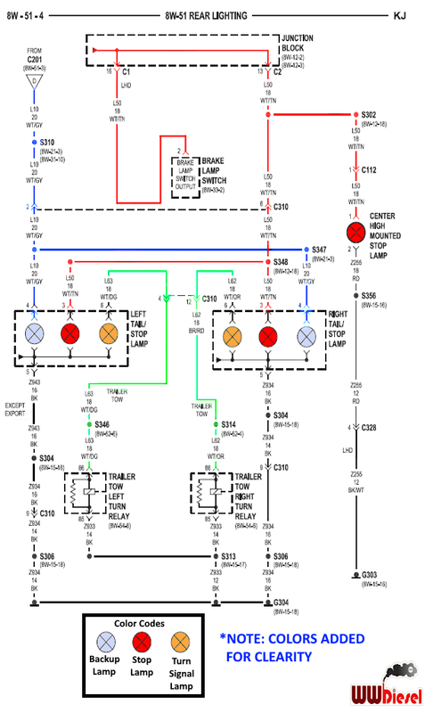

It's been a while, but I am finally getting back to this P0504 code. It's been a long, winding road, with several dead ends. I think I have made some progress, but need some advice and maybe part numbers from the folks here.
A.First prob was that aftermarket brake lite switch from Amazon. It was a dud, but I did not realize it for a while.
B. I took part the rear tail light assemblies and found the two top bulb holders burned and melted. Had the right bulb in it, so I ordered some replacements. After a bit of testing, found out those new bulb holders were nice and shiny but did not work (from Amazon again, I must be a slow learner ;-)
C. Put the old bulb holders back in the top positions, and at least I have top stop lites now.
The P0504 code seems to be gone for now, but I have not driven that any miles, so we'll see. But whether it returns or not I still have work to do on these rear lites, and I have questions about how things are supposed to be (can't trust that the parts I took out are the right ones in the right place). So here goes:
1. What is the Mopar part number for the 3 prong bulb holder (or a good aftermarket one). The working one I have has a 6100 printed on it.
2. What is the right Mopar (or good aftermarket) partno for the 2 prong bulb holder? The working one has a 6094 on it.
3. This may sound strange, but I am not familiar with how these rear lite bulbs are supposed to work (which come on for what).
a. Can someone pls tell me how many bulbs are supposed to come on when you press on the brake pedal? Which ones?
b. Turn signals are the yellow bulb at the upper clear part, which work.
c. Where are the backup lites supposed to come on (I think I am not getting them cause I don't have the lowest bulbs in)?
d.When do the lower bulbs on each side come on?
4. I am puzzled by the bulb sockets this Lib came with. Top one has 3 prongs and has contacts for all 3 prongs, so that's OK. The bottom bulb holder came with 3 prongs, BUT the hole it goes into only has 2 contacts. Should I be getting a 2 prong bulb holder for this position?
5. And can someone point me to the page in the FSM where it spells out which bulbs are the right ones in these rear lites.
Lots of questions, but thanks in advance for reading and any answers.

I'll try and help with what I can find. If I list anything wrong, I am sorry, I tried and it gets quite confusing on this item with so many different options and export models thrown in the mix. (Bulb Sockets)
Did a enhanced drawing of the tail lights showing the wiring to the bulbs.
It only shows three bulbs per side, one turn signal, one brake light, and one backup light. All of them have only TWO contacts, not three according to the wiring diagram. See drawing.
According to what I could find on the Mopar online sites, the 05 & 06 Liberty's used the three bulb socket lights (listed below).
Models using the four bulb socket lamp assemblies were for Fog lamps (Export). 55155830AH & 55155831AH
These are the part numbers I came up with for bulb sockets:
4676589 Mopar (Stop Light)
55157302AA Mopar (Turn Sig.)
Your best option is to purchase both new tail light assemblies, they come with the bulb sockets new.
These are the part numbers for the 3 bulb housing assemblies.
Rear Tail Light Housing Right -- 55157060AG
Rear Tail Light Housing Left -- 55157061AG
Google the part numbers, there are plenty of them available online, ebay, amazon, and others....
I replaced both of my tail light assemblies a few years ago due to bulbs not wanting to work at times. So I ordered complete assemblies and replaced both of them. I think I ordered them off eBay???

Thanks WW. Replacing the whole units is probably easier than trouble shooting alll these possibilities.
That diagram is quite useful, in that it shows the top center stop light just wired in parallel to the lower units. Since that lite wlways came it it shows the stop switch and wiring are working (which is a relief).
Thanks again, and have a good 4th.
