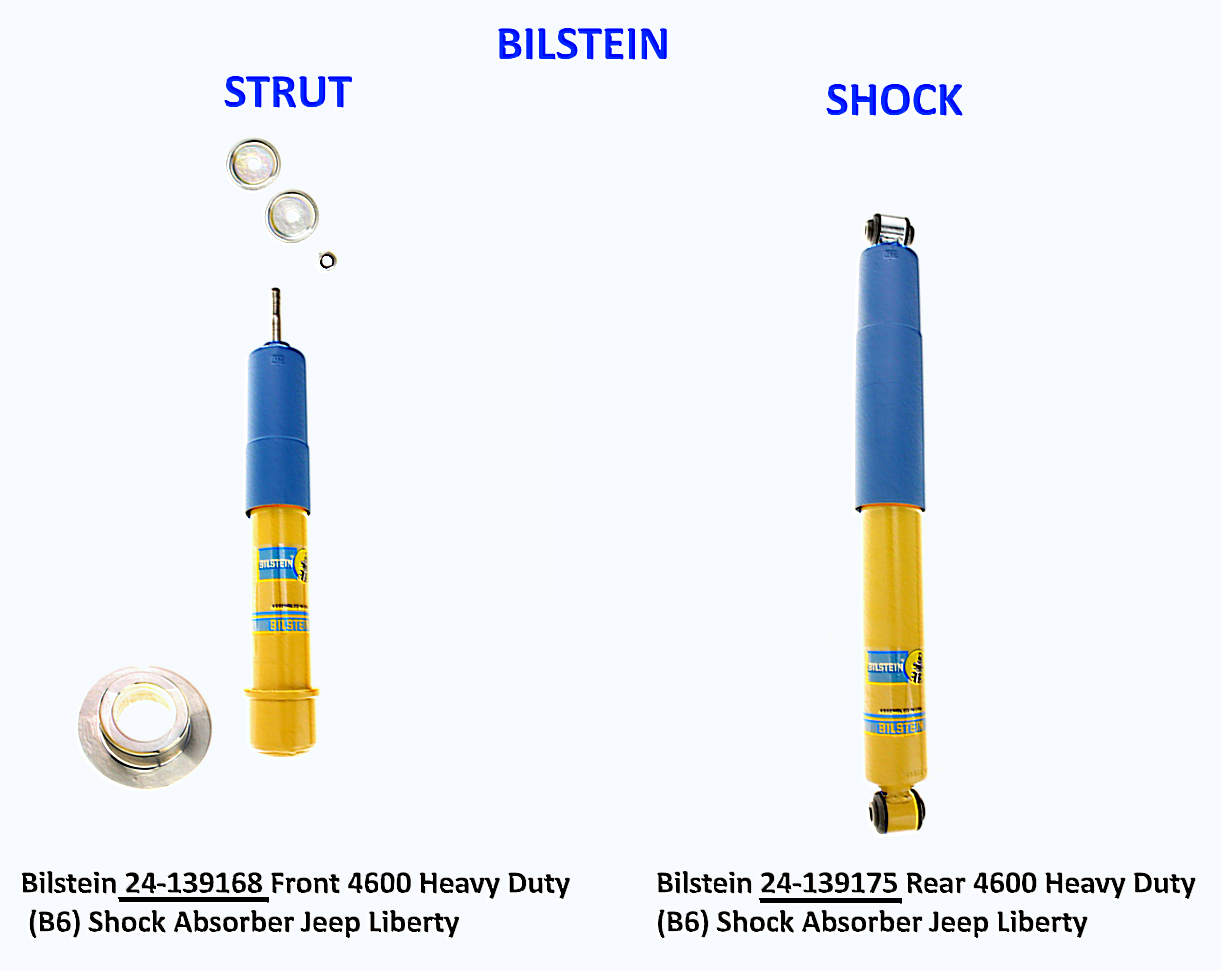

If you want a good ride and good handling, get the Bilstein shocks/struts front and rear, they are some of the best there is on the market.
Struts/Shocks:
Bilstein Brand: 4600 Heavy Duty (B6)
Part Number Position
24-139168 Front
24-139175 Rear
Struts/Shocks:
24-139168 Front
24-139175 Rear

A set of good heavy duty gas charged shocks will make a world of difference in handling and reactions to dips even with the aged factory springs. :wink:
