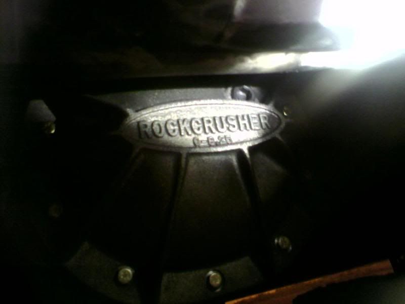

a little something showed up at my friends house that I had ordered, this is what started the whole weekend around friday at 2pm :D

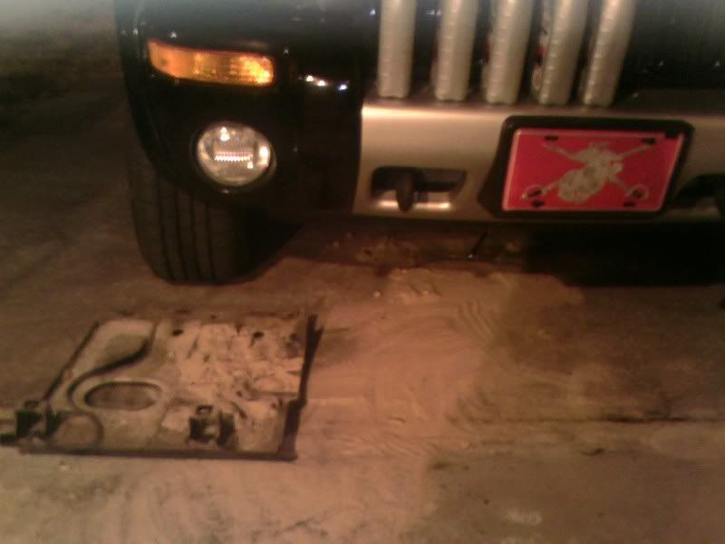

while changing my oil, i accidentally dropped the oil filter and made a little mess, well that and my friend failed to tell me that there were already 6 quarts, not 5 in the drain pan...
instead of using towels i dropped my skid plate :lol:

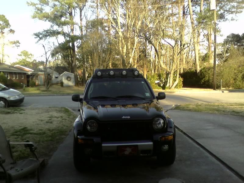

the gift from the UPS man in it's installed state :twisted:

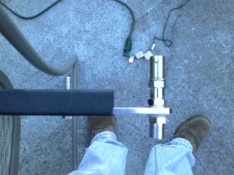

Here's the first cb antenna rack mount I put together friday
it was too long to fit inside the rack rubbermaid by about half an inch :roll: but the hole i drilled in the rack rail was intentionally put in a place where I could change the mount to a double plate clamp had it not worked, the open hole you see in the mount is a hole i drilled through the mount to line up with the hole in the rack rail for the twist down rack rail hold down screw, the bolt you see through is a hole i drilled through both the mount and the rail
here's the second mount, which is what I went with, on the bottom side of the rack you can see the edges of the bottom plate, once clamping it down, i couldnt twist it back at all so it's quite sturdy, it ended up actually not needing the ground, oh.. and putting it on the roof rather than on the rear gate completely got rid of the ignition noise and boosted the range about 300% :D

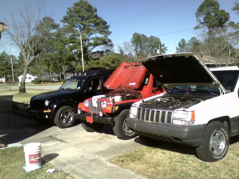

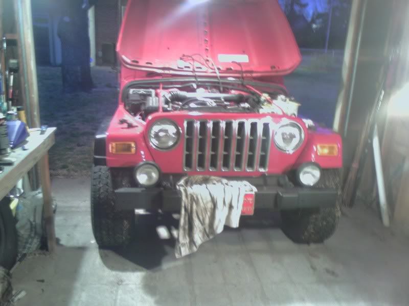

here's a pic from earlier in the day saturday (before the cb antenna)
sparkplugs and service on the wrangler, 2 idler/tensioner pullys, belt and service on the grand cherokee

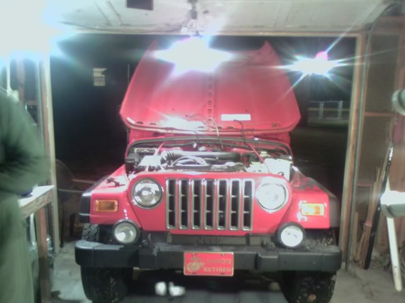

around midnight after we decided to move the wrangler to the back yard and set up heat lamps with flood lights to put in a new valve cover gasket and fix some vaccume lines

last pic of the valve cover job, the sun was comming up, my friend was falling asleep standing up, so i took the opportunity to rid his wranglers front bumper of the plastic knots on the end of the bumper, something i had wanted to do ever since he bought it about a year and a half ago..

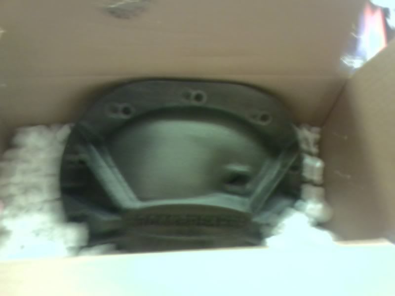

Cool, where did you get the rockcrusher from :?:

i got it from www.4x4rockshop.com their rockcrusher for the 8.25 was like 12 dollars more than the cheepest i was able to find, but.. the cheeper vendor didn't carry lubelocker seals and charged for shipping
4x4rockshop didnt charge for shipping for the cover, just charged me shipping for the lubelocker seal which was naturally sent in a separate box
its only been on 2 days but i havent had any seepage what so ever, the seal is supposivly reuseable, i figured after taking it off the 2nd time it would probably start to seep a little like rtv naturally does after awhile
but.. at 17 bucks it's not really any more expensive than a couple tubes of rtv if you get atleast 2 or 3 uses out of it and it was definatly easier to put on, i'm kinda impressed with the seal, very high quality item assuming it works long term! but just at first impression i was very impressed with it, and it's rather tacky too, i didnt even have to use any dabs of rtv to get it to stick when installing the cover, and for the sticker guru's the seal came with a sticker, the rockcrusher didn't :lol:

the other place i found the diff cover at charged like 97 bucks for the cover but charged shipping for the cover and didn't carry the seal so instead of paying for shipping for the 2 items from 2 different places i just went with 4x4rockshop, overall i think it came out about the same if not slightly cheeper
