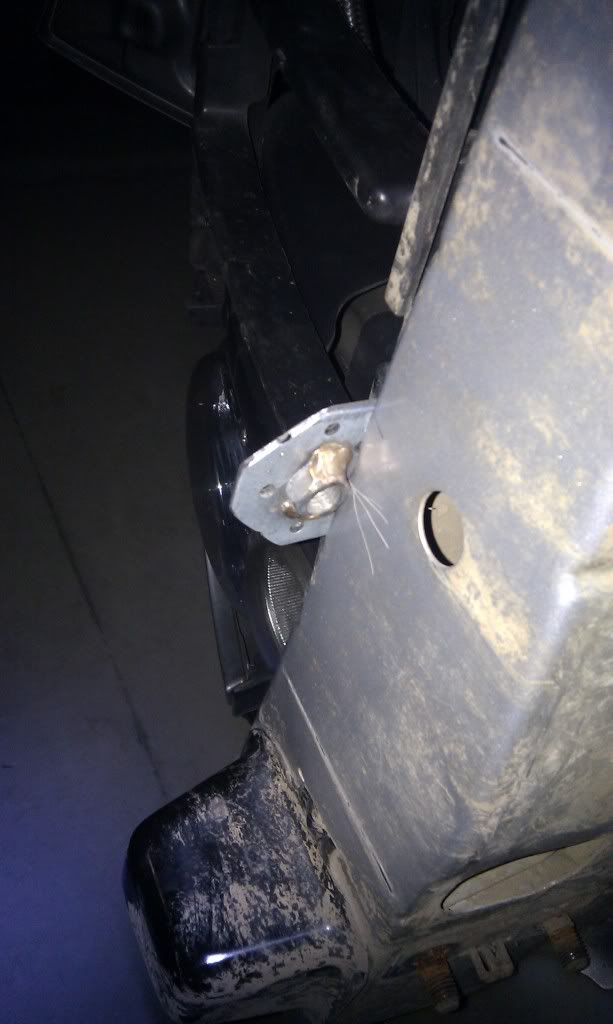

Note that the mount was not so easy because the metal bar in the bumper is very short and i had to fix an extension to be able to solidely fix the lights.

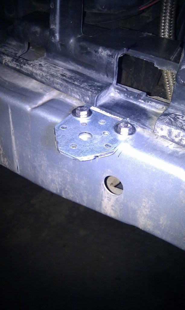

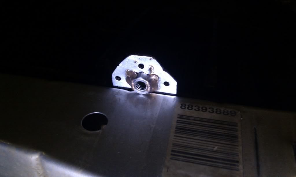

A small mechanic next door welded a 10mm bold to a metal plate i gave him. the metal plate is just long enough to create a nice support for the light.

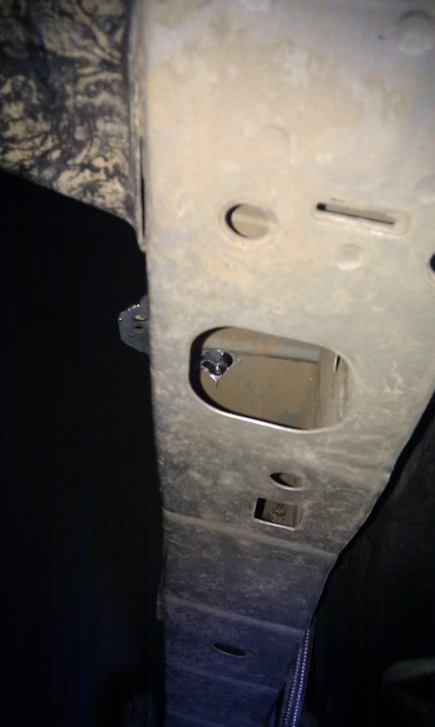

View from below:
I fixed the metal plate with 2x 6mm screws. It was really a pain in the a.... to reach underneath with the wrench and the bolt. But i did it through the holes where the tow hook is fixed. (had to remove the tow hook on the left habd side) Took me approx. 1 hour to get it right:

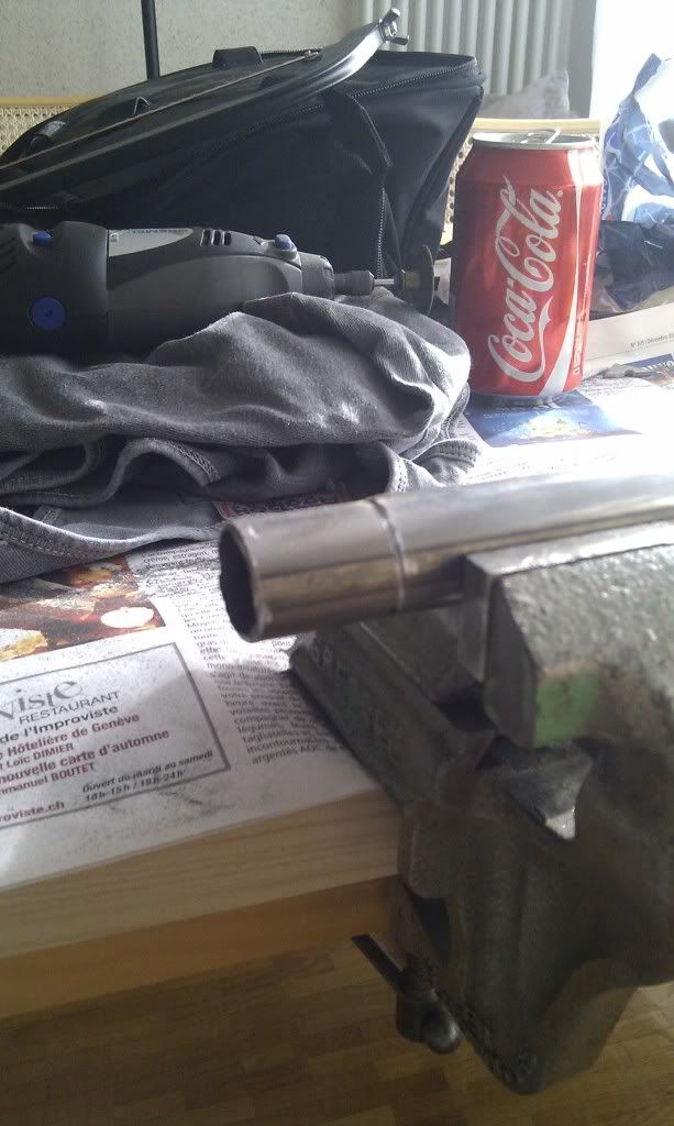

I cut 2 tube 22mm long in pipe of 2cm diameter. i fill them in with a piece of wood (to stop them to move around) ....ok, try there not to focus on the Coke can...not easy hummm ?? :SOMBRERO:
I cut the inside of the front bumper. The inside is black and very stiff. i cut one small scare on each side in order to allow the metal plate and the bold to come in.
(sorry no pic, the wife was screaming that i was doing that in the living...not even true, she laughing her head off :D )
once this was done , i measured the distance of the bolt on the metal plate from the grill. just to be able to have an idea of where to drill trough the bumper.
I mounted the bumper back on, drilled 1 -2 small holes to see was the bolt, then used a 2cm drill through the bumper, inserted the 22mm tubes and fixed the light bases.

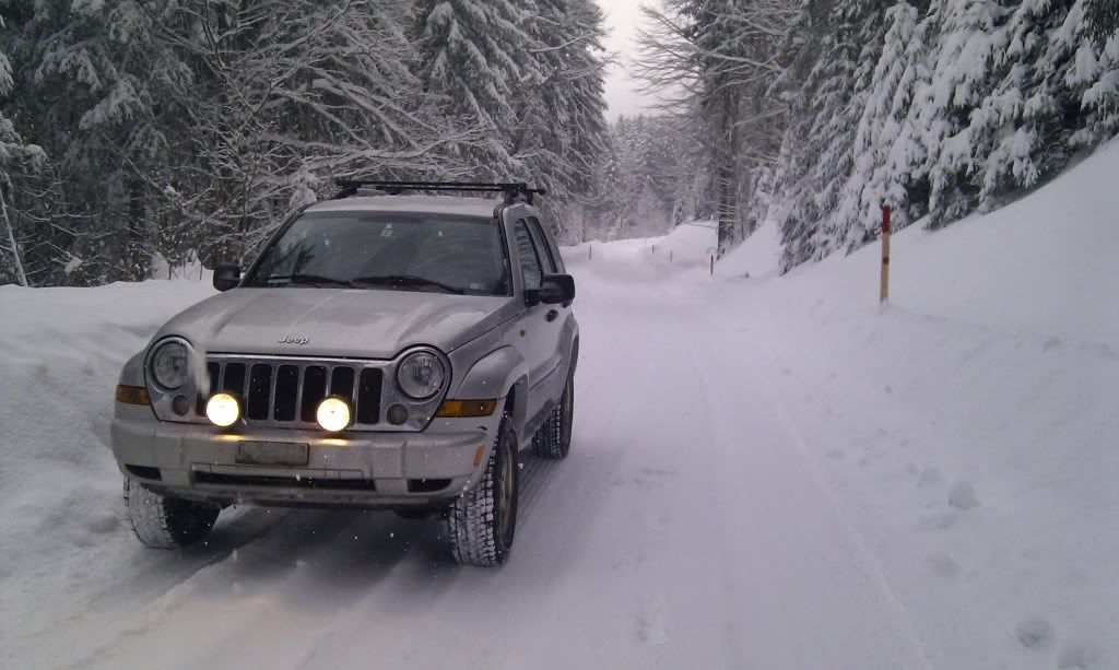

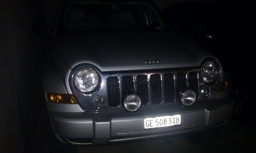

To me it fits perfectly, i can even remove the lights and the basis don't look uggly.

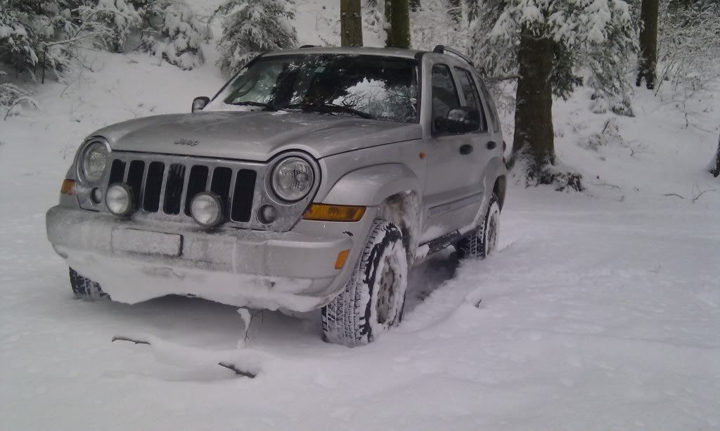

Here are some pics of the lights off.
and on...

Looks good but I don't understand the part about the pipe. What is it for? Do you have a close pic of where you cut the bumper?

sorry for the late feed back but here a re a few more pics to answer your question:

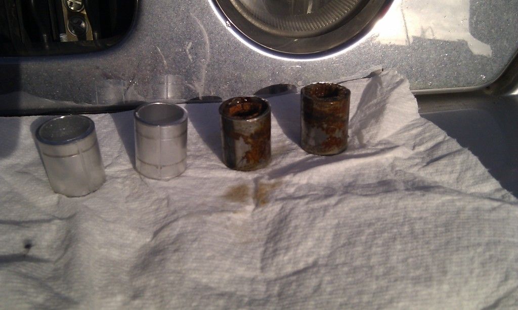

the section of pipe is the allow to tighten the light to the metal plate with the bolt = It fills in the space between the metal plate and the surface of the plastic bumper. without these pipes i would have just smashed the pasteic bumper.

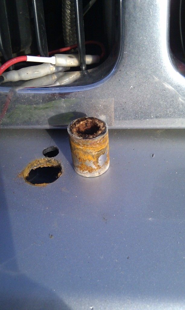

this is a pic with the light still mounted, you can see the rust appearing at the top of the pipe.
I used normal steel pipe at first, and after just 3 weeks i could see some signs of rust. i open the whole thing, look a bit a the steel pipes, not very clever.... :shock:
As a replacement, i bought an aluminium pipe and cut the same small sections in it:
hope that answers your question :SOMBRERO:
