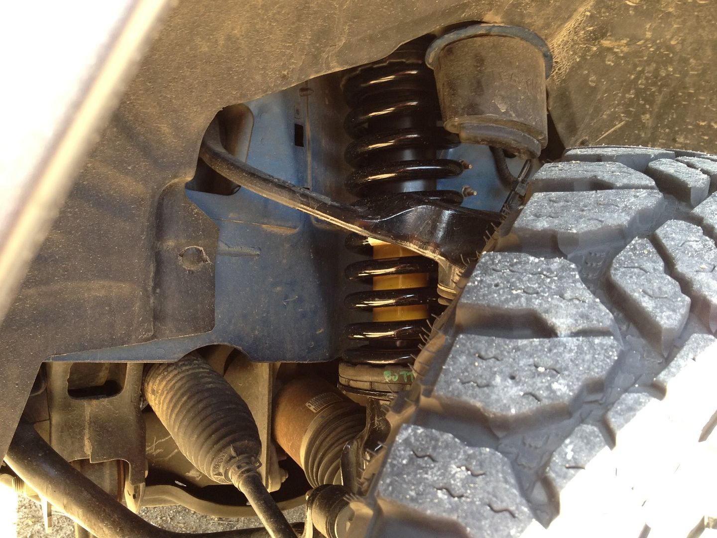

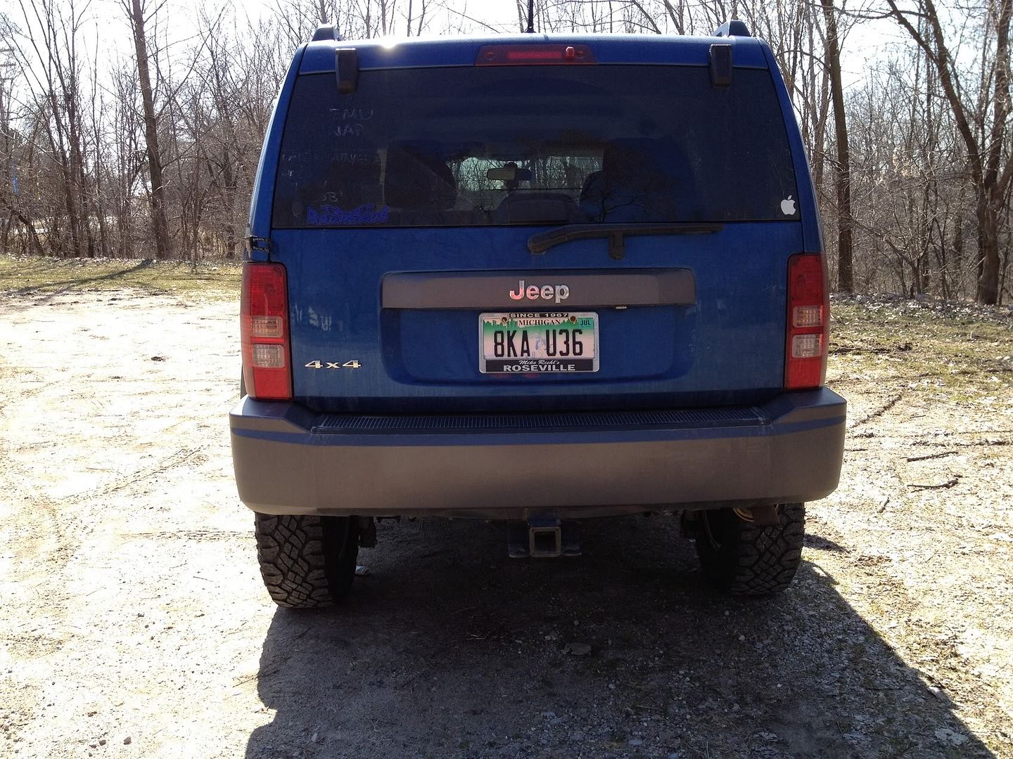

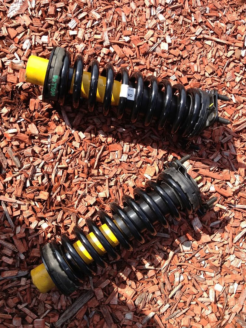

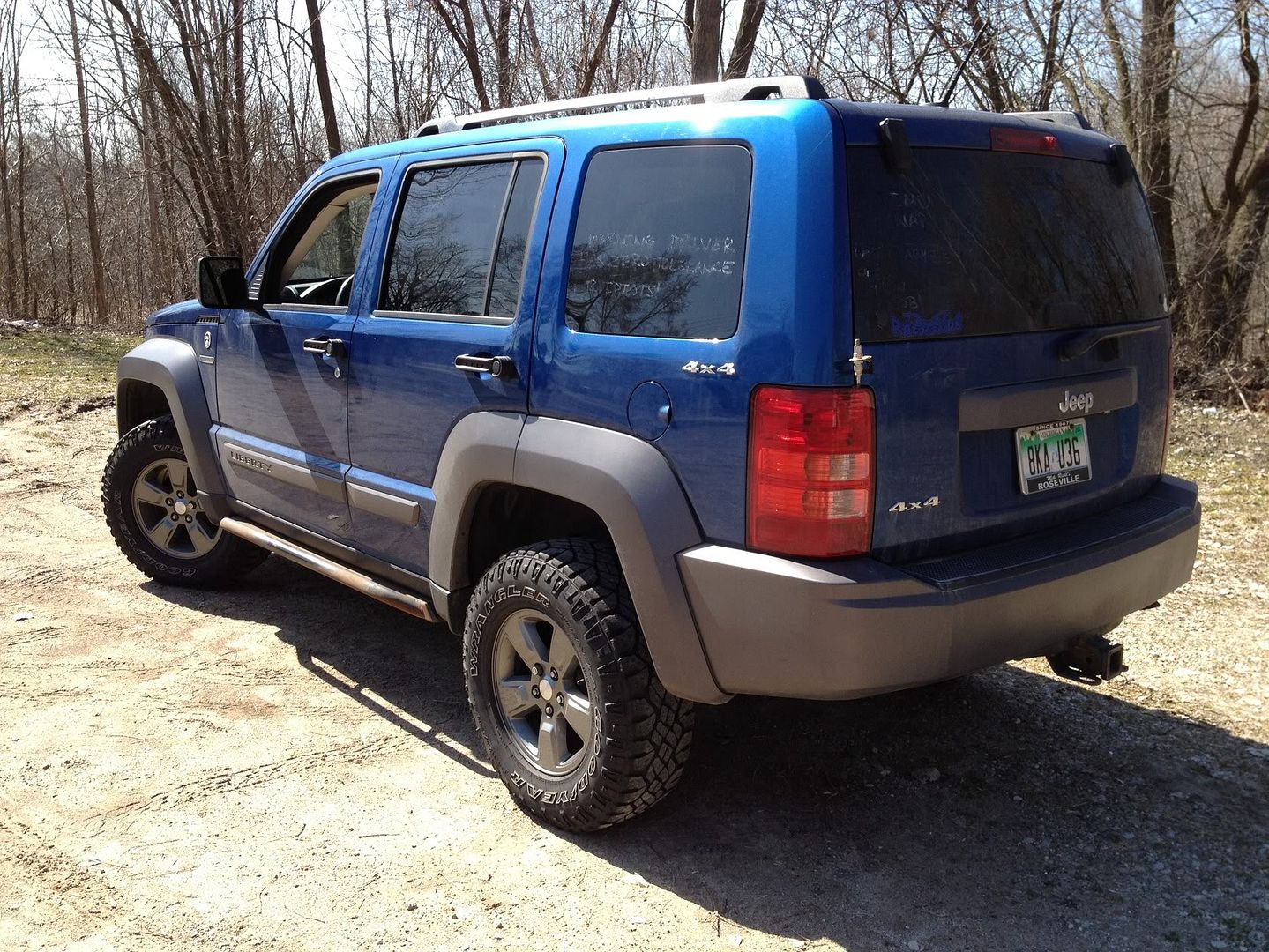

Pics after my OME.
Front:
OME927s
NS131 Shocks
Two Conduit Nuts per side
No Top Plate
Rear:
OME731s
Monroe SensaTrac Load Leveling Shocks
Two Upper Isolators per side

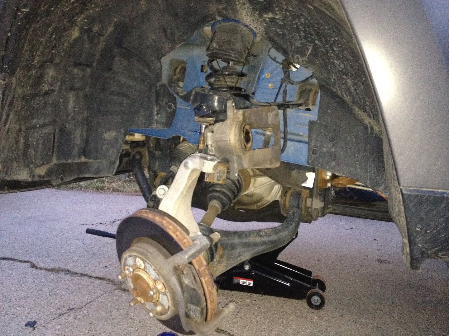

Tom, you have to remember, I'm spoiled. At work, I have a $10,000 tool in my hand. Even after 550 Jeeps, I am nowhere near sore. I normally don't do mechanical stuff by myself (I can wire up some stuff in a few minutes though.... :) ), and I must have been pissed that day after all because I tightened up those lug nuts so much, I had to find a 8' long pipe to use as a breaker bar for the lug wrench!!! I think that's what really did it, I spent way too long trying to take the wheels off. But yeah the only help I had was with the dang UCA... heh

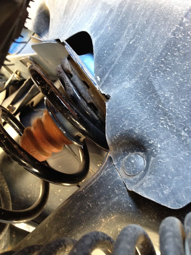

I have a question, I see you are still running the factory UCA did you have any contact with the UCA and the Spring?
I put the same lift on and have slight contact on full droop. Did you shave down the UCA or is that to dangerous, I plan on ordering better UCA soon but in the mean time.

I specifically asked what I would need for my lift in another thread and I bought what people told me.
Yeah I'm getting a very slight contact on full droop. I just found out today.
Oh well, guess I just have to take it apart again, install new arms, and maybe by then I can do even more tricks to lift it even higher since I'll have the clearance!!! :-)r
