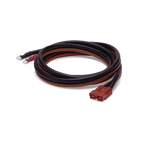

Electrical/Wiring:
Okay, here's a parts list of what I will need. Let me know what I'm missing and I will update the list:
I wont need the front Quick Connect Power Cable since both above winches come standard with it.
Item #1
Sears DieHard Platinum P-1 Group Size 34 battery. The P-1 Platinum has 135 minutes of reserve capacity, 880 cold cranking amps, 4year free replacement and 100 month prorated limited warranty.
Item #2
20' /6m Quick Connect Power Cable; for rear of vehicle. Includes Power Interrupt Kit
PN 32963
$234.60
OR
24'/8m Quick Connect Power Cable; for rear of vehicle. Includes Power Interrupt Kit
PN 32966
$251.78

For the back why don't you just get a set of 2 gauge heavy duty jumper cables and put a set of red SB175 connectors about a foot from the end. Save you some serious bucks and you would have a set of really neat jumper cables to boot. You can get the jumper cables for about $50.00 and the SB connectors for around $20.00
After reading that suggestion elsewhere, the thought did cross my mind. But then I read that most cheaper jumper cables are inadequate for such purposes. And the adequate jumper cables are expensive, so then I found myself back to square one, lol. What I'll probably do is first measure how much length I'll need and consider having them custom built to specification. Warn sells two different lengths. If one of those lengths is near what I need, then I’ll probably go with Warn. If you shop around, you can find the Warn cables much cheaper than what I posted from their website.

Your reasoning makes sense. For sure you can make a rear set up with a RED (dig) connector and some welding cable cheaper than you can buy a Warn made one. Up to you on how much effort you want to put into it in the end. Hate to pay Warn's mark up although I have Warn winches on both of my 4x4's. I did use 2 gauge on the winch hook ups as that is the size on the winch QDC.
Also know that red is generally 24 volt although we use see mostly gray SB175's on our industrial batteries. (forklift dealership)
