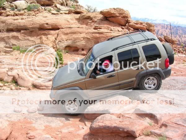

Eventually, we drove out to utah to meet some of the LOST crowd and I had the opportunity to test out my KJ modifications.
the KJ boulderbars mount to the unibody "frame" rail and also to the rocker panel pinch weld....

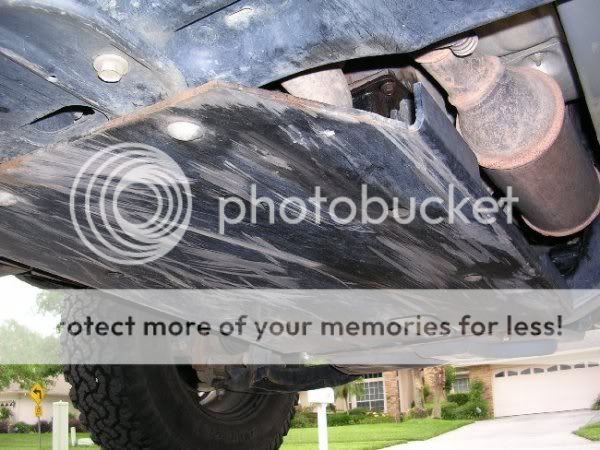

the transmission "superskid" allowed me to slide over the redrock terrain in Moab....

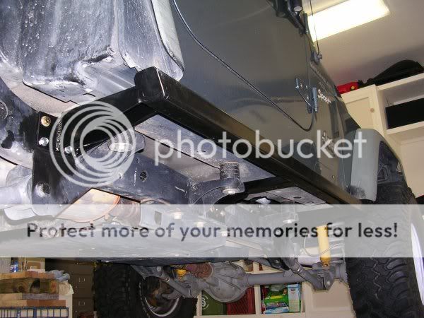

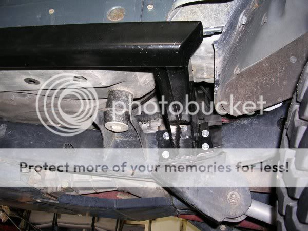

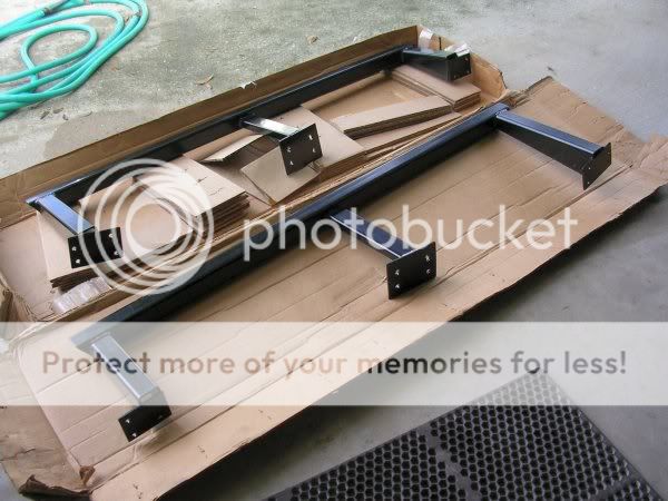

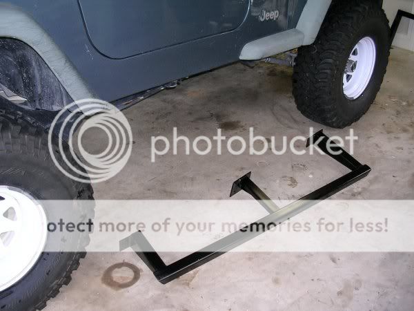

You can order "boulderbars" for no body lift....or for a 1 inch body lift. About a year ago, I installed a 3.5 inch "rubicon express" spring kit and a 1 inch body lift....along with a bunch of other stuff. I run 33 inch tires. I ordered the "boulderbars" designed for the body lift. The support arms are tapered to position the 2 inch square tube rocker bars up near the body sheet metal. You can see I never bothered to address the faded plastic flares. I've been looking forward to removing the small mud flare.

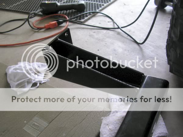

The next three pictures have the boulderbars upside down. You can see how the front support arm is constructed of a three sided channel that tapers toward the main bar. There are four bolt holes in the forward mount flange and I'll need to drill four new holes in the frame for this location.

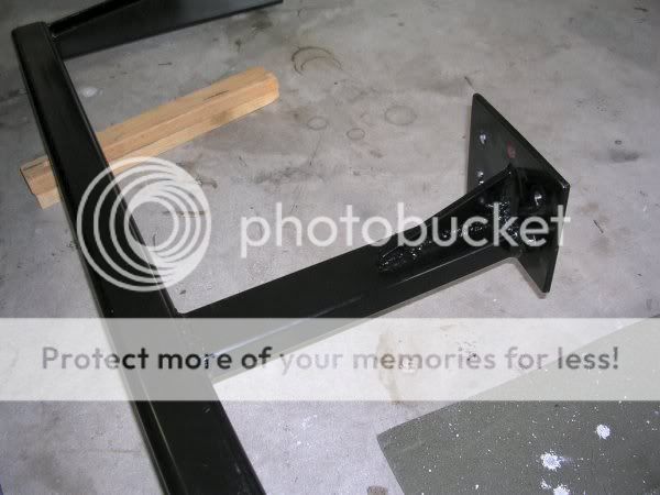

The center support is a closed rectangular tube with a gusset at the mount flange. There are already four existing holes in the frame for this flange. The frame holes are too large for the supplied 5/16" bolts. So we'll install threaded inserts in the frame for this location.
The rear support arm is designed like the front with a three sided channel that tapers toward the main bar. This mount flange only uses three bolts. Three new holes will have to be drilled in the frame for this location. That makes a total of seven new holes in the frame for this side.

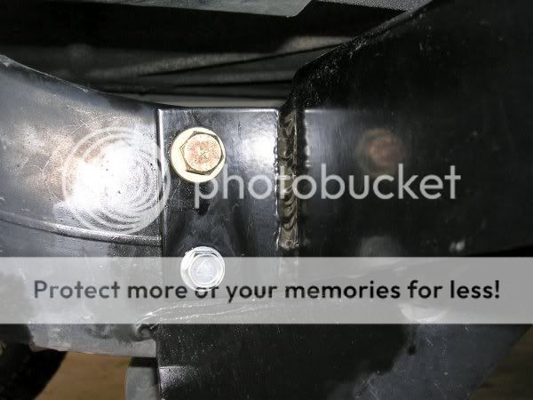

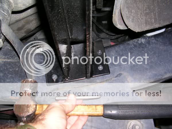

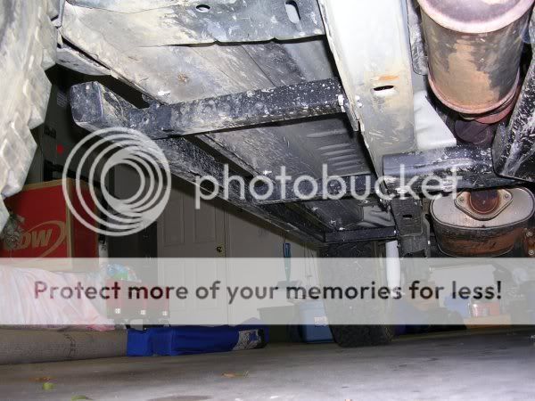

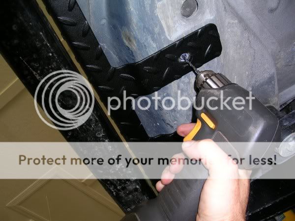

These are the four frame holes that exist for the factory side step option. The holes are too large, so the hardware kit includes some internal thread "nutserts" to allow use of the 5/16 inch bolts. You slip the insert into the frame hole and tighten the dummy bolt against an oversize washered nut. As the bolt is tightened, the insert swells to fill the hole....just like a pop rivet works. You have to be careful not to over-tighten the bolt or you'll strip the internal threads. Installing the inserts is very simple.
You temporarily hang the boulderbars on the four center bolts to align and mark the locations for the front and rear flange mounts. I used a jack to slightly tilt the bar parallel to the body line.
...then mark your holes for a pilot drill bit.
I used a 1/8 inch bit to drill through the frame. It's much easier on your tools and your arm to drill a small pilot hole first. I never seem to be able to center-punch my holes very accurately. Fortunately the mount flange holes are just slightly larger than the 5/16 inch diameter bolts so being slightly off center won't stop me. Still, you have to be pretty accurate or you can have problems.

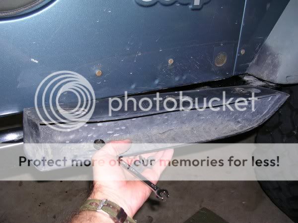

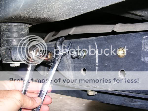

While I was involved in this, I went ahead and removed the plastic mud flares They're easy to unbolt. But the resulting look isn't appealing. I was planning to fab up some kind of kick plate to hide the ugly. A little later, I reinstalled the plastic flares for the time being.

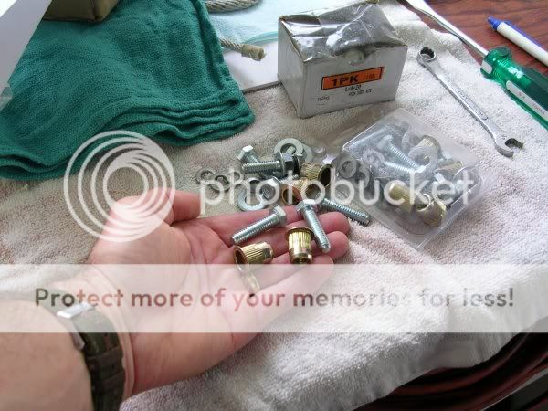

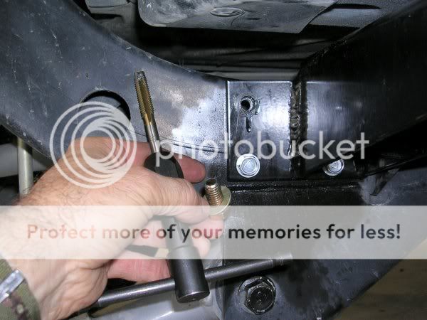

The center support is bolted to the frame where the thread inserts were installed. The front and rear mount locations will use 5/16 inch thread rolling bolts turned directly into the frame steel. A "F" size drill bit, commonly sold with a 5/16 inch thread tap, will enlarge my pilot holes and allow these bolts to cut their own threads as they are installed. Supposedly, there's a subtle distinction between a self-taping bolt and a "thread-rolling" bolt. At any rate, I'm only gonna get a couple threads in the frame rail, so I hope these work.

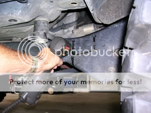

...this picture is staged....I'm drilling the final hole size with the "F" bit.

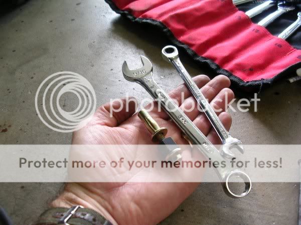

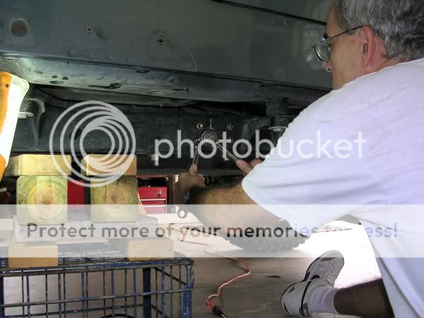

I own a couple good torque wrenches, but I hardly ever bother with them. I've turned a few wrenches and usually with the correct size tool, you can feel a lot in your hands. The front four bolts went smooth. I guess I over-torqued one of the rear bolts though. I lost the thread bite, even with a different bolt. So I drilled the hole out and threaded it for a 3/8 inch bolt....another grade 8 from my coffee can. I searched the internet for the triangle shape on the supplied "thread-rollers" bolt head. I never could find any information about their hardness.
I had to remove the rear tire so I could spin the tap handle....

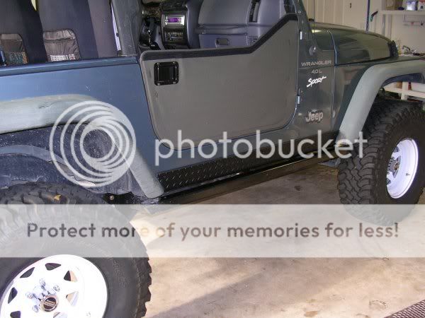

A couple of looks after this side is bolted on....

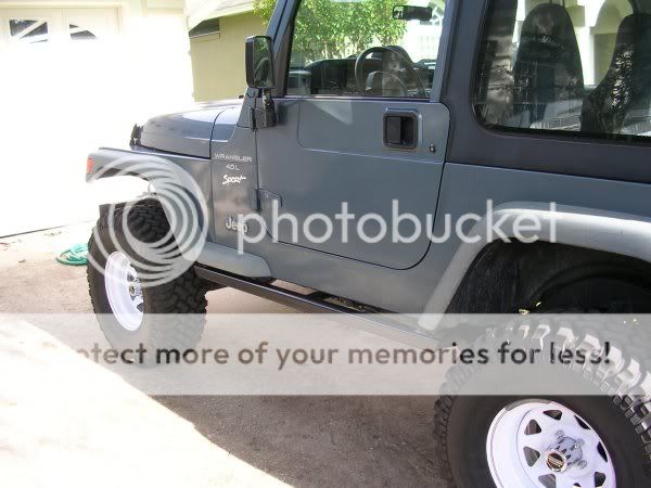

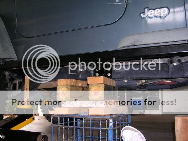

So, I switched to the driver side....installing the center four inserts....
The process is the same....hang the bar by the center mount and mark the forward and rear locations for drilling. Drill pilot holes and then switch to the "F" drill bit. Carefully tighten the thread-rolling bolts so you don't strip the threads.
This time I was all done and was just going back to "snug-up" all the bolts. I ended up snapping this one. It may be that I didn't have my hole centered well enough or the threads weren't cutting perpendicular to the flange. Once the head of the bolt bottomed out, it may have had a slight tilt and snapped. Who knows? It wouldn't have been a typical project if everything went smoothly anyway. I had to core-drill the broken stud out of the hole and re-thread it for 3/8 thread. These triangle marked bolts are definitely not over-engineered by any means. I hope the folks at "boulderbars" get a chance to read my story at some point. If so, count me as a customer who would gladly pay a premium for top-shelf fasteners.

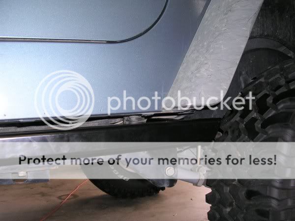

I ended up with about 1/2 inch more clearance on the driver side. As you can see, I have almost a full inch here. Again, these bars are supposed to be for a 1 inch body lift, so I was expecting a little less gap here. I reinstalled the faded plastic for now.

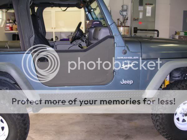

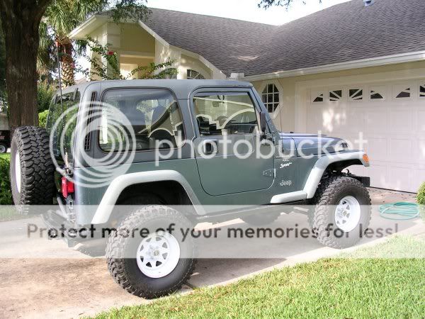

...a couple of driveway shots....

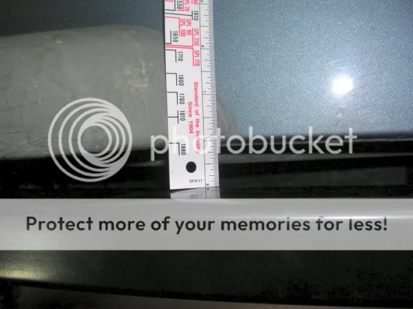

I have 23 inches below the center of the bars to the ground....I have about 19 inches clear under my belly-up skid. The bars cover the full length of the rocker area...all the way under the fender flares. I can still leap into the jeep without dragging my work pants over the bar. I'm pleased with everything. I just don't like the plastic flare.
I have a high-lift jack collecting dust in the garage. I'll try jacking up the jeep one day soon and take some pictures. I'm gonna go looking for some scrap aluminum to make some kick plates.

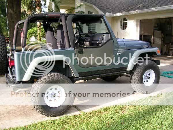

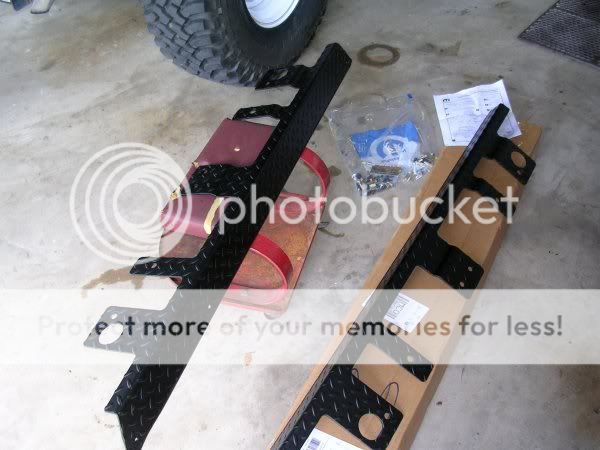

So after a week of driving it with just the boulderbars, I decided to go ahead and get the mopar diamondplate rockers to finish the look. I checked a local scrap hardware shop for some aluminum plate, but they thought too much of their stuff. I was hoping for basically "free" and I don't have a way to bend a four foot piece of plate to make it look good. I would still need fasteners, etc. So I just figured I'd go ahead with a known product. I checked ebay, but by the time good used rockers sold, they were too expensive. I ordered new from "jeepsareus.com" out of New York. A fella named Tony owns the outfit and he sells factory parts at a reasonable price. I've spoken with him and he's friendly.
The diamond plate rockers are factory on the TJ rubicons. They're powdercoated steel with a rubber backing, and you get a bag of hardware.

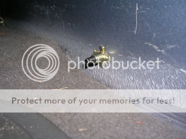

I pulled the plastic mud flares and drilled out the three inserts in the sheet metal. I waxed up the paint just for the heck of it before hanging the new rockers.
...these three holes will not be used again, but I wanted the inserts out so the diamondplate would sit flat.

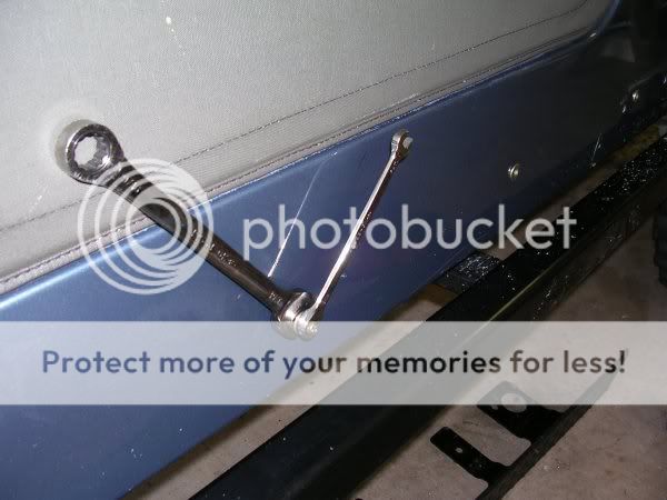

You have to drill five new holes in the side and five in the bottom. All the holes will use thread inserts. The inserts are similar to what was used for the boulderbars. A little different, but same concept.
...these inserts work like drywall anchors...they collapse very easily with a couple wrenches. The kit bolts are only little 6mm thread...not much for strength. But I only wanted these rockers for the kick plate function and to finish the overall look.
I'd prefer a flat black look instead of the gloss. Here in Florida, it won't take long for the shine to fade. The install was very simple and I'll be able to remove these from time to time to check on any rust issues underneath. With the rubber backing, I decided I didn't need any additional sealers.
