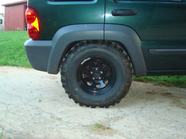

Good morning ya'll,
Alright I have a question for you... I found a wheel and tire package that includes (4) Soft 8's 15x8 with 4" BS on some Mickey Thompson Baja Claw tires that are 31x10.50-15.
I was looking at the tire guide but could not figure out this tire size with the chart. Closest thing I got was 31.8 10.5's that requires at least a 2.5 inch lift.
Anyone care to share their knowledge on this one...
Here is the pic for reference:

That set up (size wise) is what I and a few others here run. It is just ever so slightly bigger (depending on the tire) than the 245/75/16 size a lot of folks run. You will need at minimum 2" of lift (2.5" would be much more realistic) but you will be pounding the pinch weld and cutting wheel well liner/fender flare either way, especially with a mud tire.

combining suspension kits will get you nothing but trouble really, and Rustys have the same spring rate as stock so you are notupgrading anything, why not go OME springs, Rancho shocks, a clevis lift and you will have the 2.5 or more inches you need. springs shocks about 650
OME heavy Duty springs front OME927, Rear OME 948
shocks front Rancho RSX 17505, Rear RSX 17004
No there are no fender flares available except for stock at this time..until Rock Lizard does some ...hint...hint
PINCH WELDs If you look at the rear of the fender well behind the front tires you will see a small section sticking out forward, this is where the pinch weld is , there are various writeups on here about how to do it or ask and we can explain further
also with that wide of a tire and 4 inches of backspacing you will have to make sure you have some really good bumpstops in there as well. Two hockey pucks drilled through the center and bolted down to the spring perch in the rear works great and for the front Teraflex part # 0019301200 were about 17 bucks each
My Moabs with 5 inches of backspacing has the wheel/tire right at the edge of the fenderwell, 4 inches will have it on out and hitting more

im running the 15x8 soft 8's with the 4" BS and TSL's. yeah with a 2.5" lift they will fit and run great in the dirt and sand and mud. but they will be loud.
