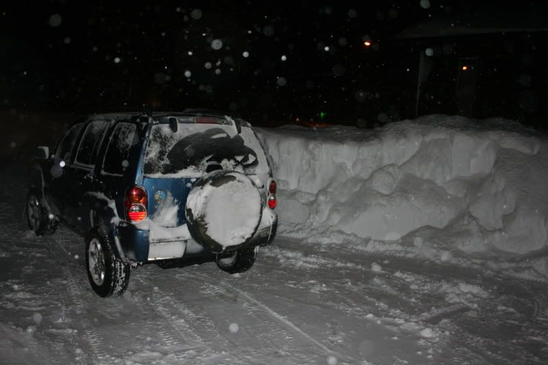

Im up in Northern NB ... my snow banks are still 4-5' high ... so snow is a slight problem where I am at ... salt - not so much as it is only for a month or so when melting is significant...
Here was the last bad storm we had almost a month ago after I plowed it out:
I dont want to get the 265/75/16 as they wont fit ... I was originally going to go with the 265/65/17 as I have 17" on my Jeep now ... but the turning issue came up since that tire would be 3cm wider ... It wont make a difference when I get an ARB bumper and cut it off (I dont want to cut it without the bumper as it would look funny, the looks matters to me) but I am not making 2 large purchases right away for my jeep.
