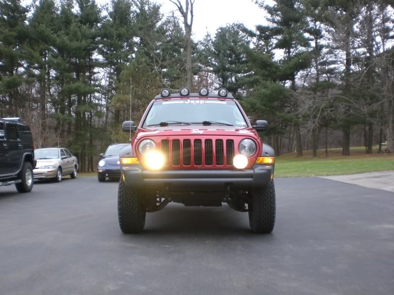

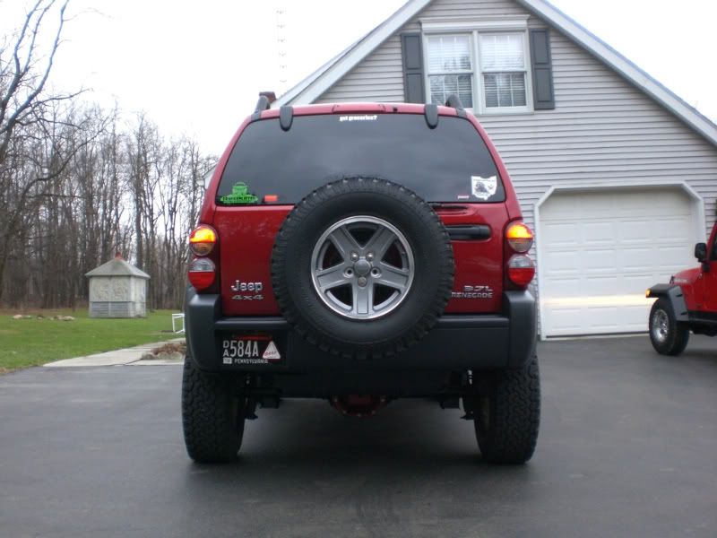

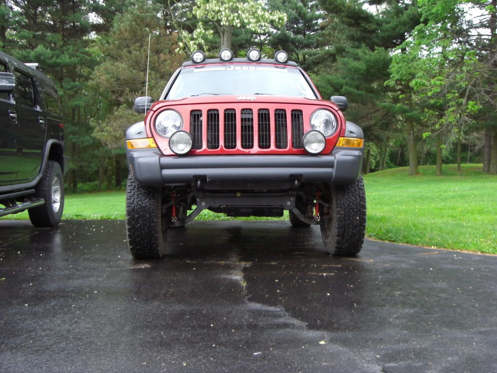

PostPosted: Tue May 19, 2009 8:28 pm
here is mine with stock wheels ... 1.25in spidertrax and 265/75/16 BFG AT KO's lifted about 3 to 3.5 inches with a frankenlift.
hope it helps!! i bought the spacers because i REALLY liked my stock wheels. but if you arent in love with them just buy some cheap steel ones with the correct offset. wish i wouldve done that in the first place. i didnt know the spacers cost almost as much as new wheels :shock:
