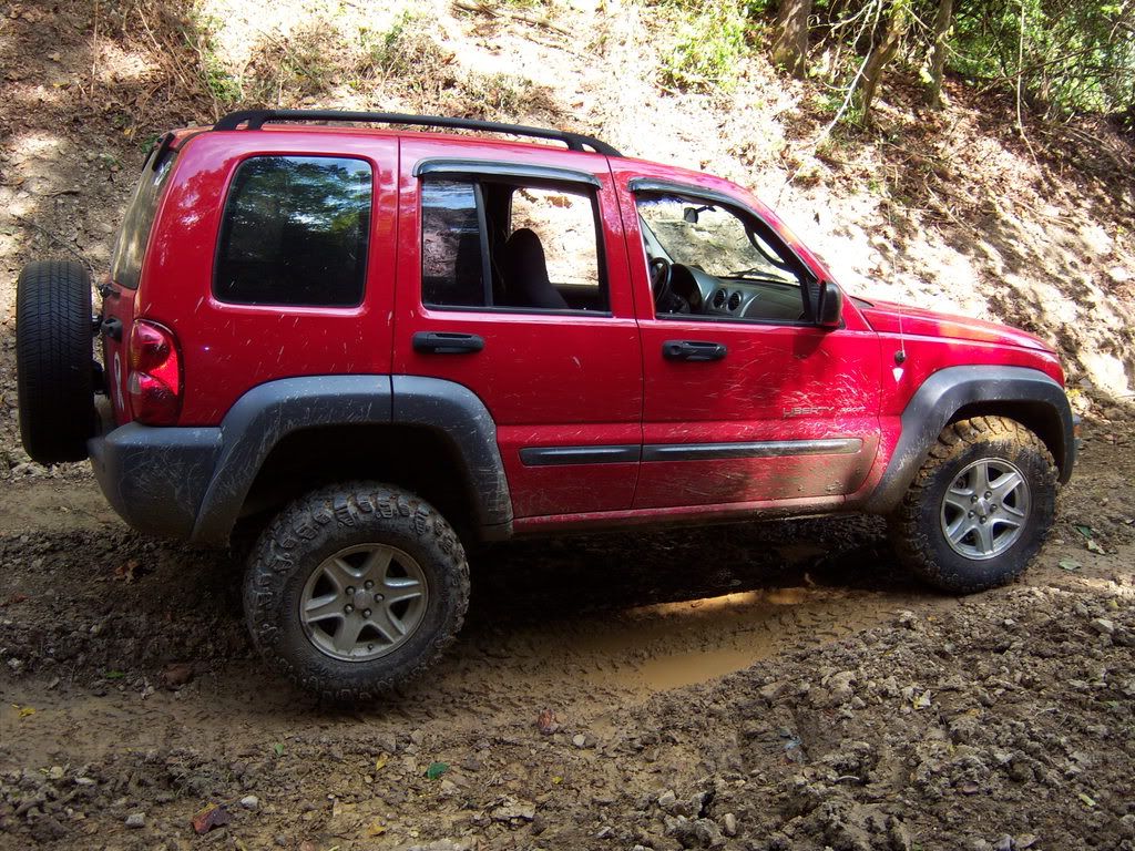

2.5" daystar lift swamper Irok nds in 245/75/16 (no longer producing that size)

any rubbing on them

yes at full turn they grabbed at the inner plastic near the lower a arm behind the wheel and made a nasty noise.

did you cut the fender wells out and if so do you have any pics of it?

where it was rubbing there was nothing you could do other than wheel spacers or new wheels.

O ok how much offset did you have?

idk they were stock wheels

what back do you have now?

15x7 soft 8 with 4.25 backspace with 31x10.50 15 Goodyear Duratracs

Do they stick out past the fenders and if so how far? Thanks for answering all my questions I know I have alot of them I'm not new to building trucks up but it will be my first IFS build and a first for building any kinda jeep so all the help is great.

No thankfully they dont, cause that is illegal here. It is really close though.
