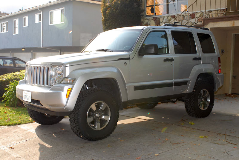

Adjusted the fronts to fit my new BIGGER tires.
The ride is so smooth it is not even funny!
And YES the 265/75r16 do rub on full turn!
And you would NEVER believe me but the spare fit!
I also updated my PICTURES OF MY RIG PAGE check it out it's a picture story of my KK. comments welcome...... Happy getting LOST

Sexy 8) 8)
Any rub?

Oh the rear almost don't fit. I can't even get a finger in between that diagonal brace to the rear axle.
The front are rubbing but not sure on what as it is only while driving at FULL lock.
It is SEXY! :BANANA:
My wife want to know when can she drive it. :JEEPIN:
Fronts is adjusted to 22.5" center of wheel to bottom of fender. (Full droop is 24.25" without tires)
Rears sit at 22-5/8" center of wheel to bottom of fender. (Full droop is 26.25" without tires)
And it only cost a few :2cents: The tires were a steal! out the door 5 tires only $1023 :shock: :shock:

Very nice! That is a steal at that price!

to see what it is rubbing on do what i did... take some sidewalk chalk and cover the inner wheel wheel as best as you can... take it for a drive ( do full lock , flex, obstacles, fast turns etc)... then bring her home and see where the chalk is missing... works like a charm... as a note... obviously don't hit any puddles or get the wheel well wet as this will wash away your chalk :lol:

Front is likely rubbing on the sway bar at full lock with the stock wheels, that's where my 245-75 R16's rub. So I imagine your wider tires will rub a bit more there.

Yes sway bar so far...
