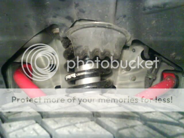

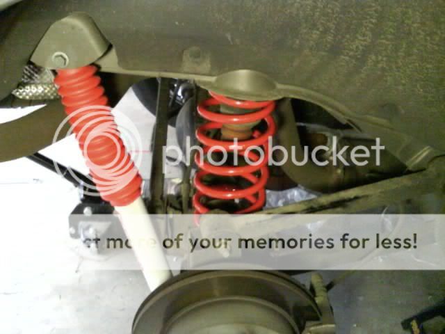

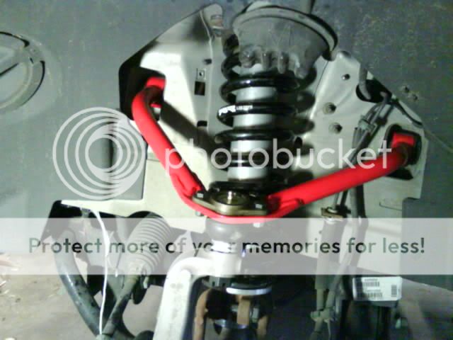

The kit;
Front;
Back;

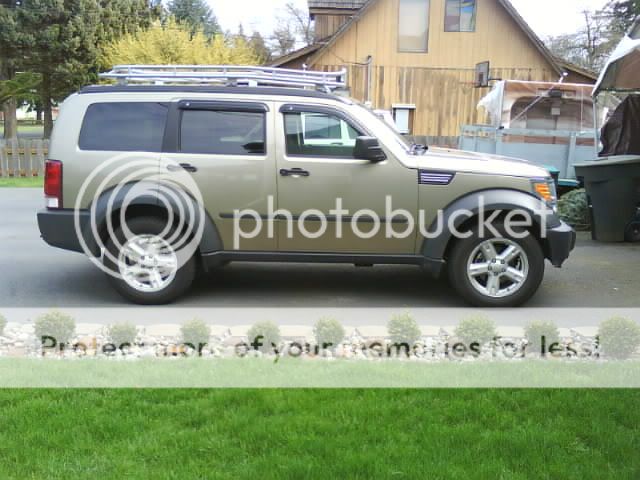

Before;
After;

Now that it has had time to settle, I have remeasured it. I am sitting around 1 3/4" lift in the Nitro (KA)
I measured at 6 points;
Both sides front pinch weld, just behind the front mud guard.
Both sides rear pinch weld, just in front of the rear mud guard.
Center of the front lower bumper.
Trailer hitch.
Had a little issue with the A-arms hitting in the top of the front pocket. Marlin is working on this.
Left
Right. This is the side I flexed. A little more pronounced.
There is only about 2" of clearance on the front strut/shock until it is at full compression, from riding height. So I don't think the knuckle will go up much higher. I will do another flex test and see how close the strut is to full compression when the a-arms hit.
