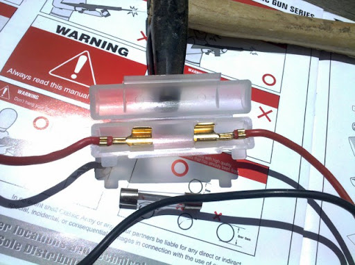

I then soldered the power wires up to a fused lead and piggy spliced into the cigarette light power using screw terminal connectors:
