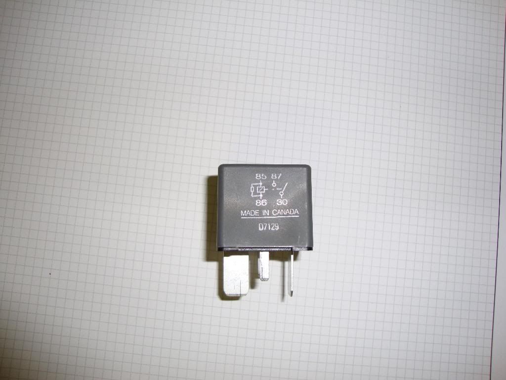

Also, I am pretty automotivly challenged. I have no earthly idea what the relays look like. And what is the differences between bad relays vs. good relays. Pics would be great. Thanks everyone for the help.

I really don't think it's your T-Stat.
As far as what the relay looks like:
