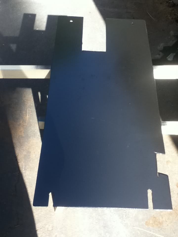

Transmission skid done.
My first plan was to drill through the rearward crossmember and run a bolt all the way through it, but i'm having second thoughts about drilling into the crossmember. One it looks like a total pain, second i don't want it to rust where i made the new hole.
I measured the hex shaped hole where the nutserts are suppose to go and it is 1/2". I found these which have a 1/2" hex on them, will they work?

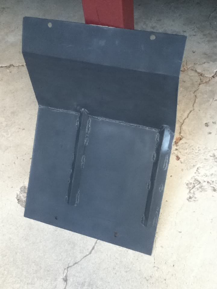

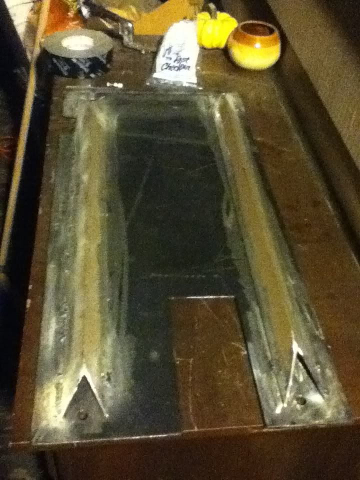

I decided to reinforce my transmission skid after doing some research here on lost. Not done welding it yet but this what it will look like.

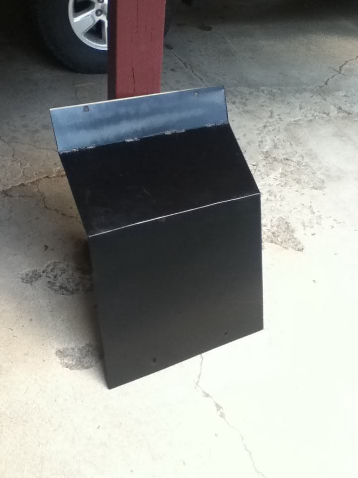

I formed a front skid that goes from my bumper to the engine crossmember.
Pics of it installed later.
Those nutserts i got fit perfect, but after installing them i thought they looked weak and didn't want to have problems later on. I just drilled a 3/8" hole through the crossmember to run a through bolt.

First one done
