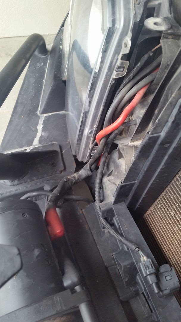

But Texas I'm a little confused on where you ran the cables through to get from the winch to the engine compartment do you by chance have a photo of that? Just because I am just running my current wires through the grill which I don't like just do to if I need to take the grill of which I am I then have to take the wires off the winch :banghead:

The wires are ran through the passenger headlight area on mine. Tucked the wires under the lip at the back of the bumper for a cleaner install

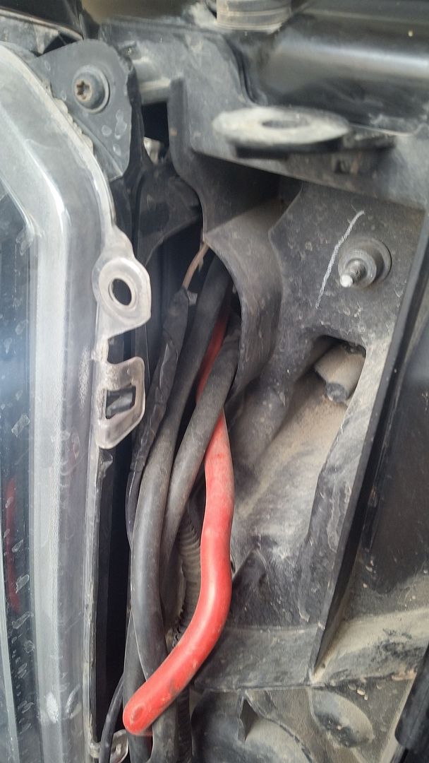

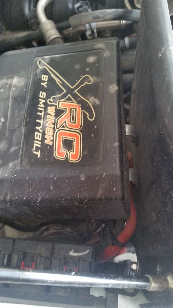

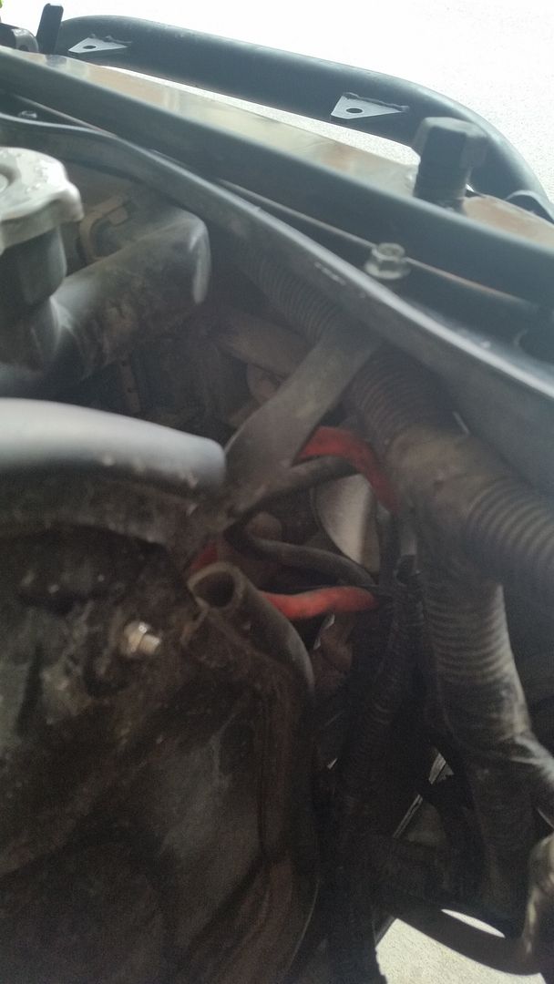

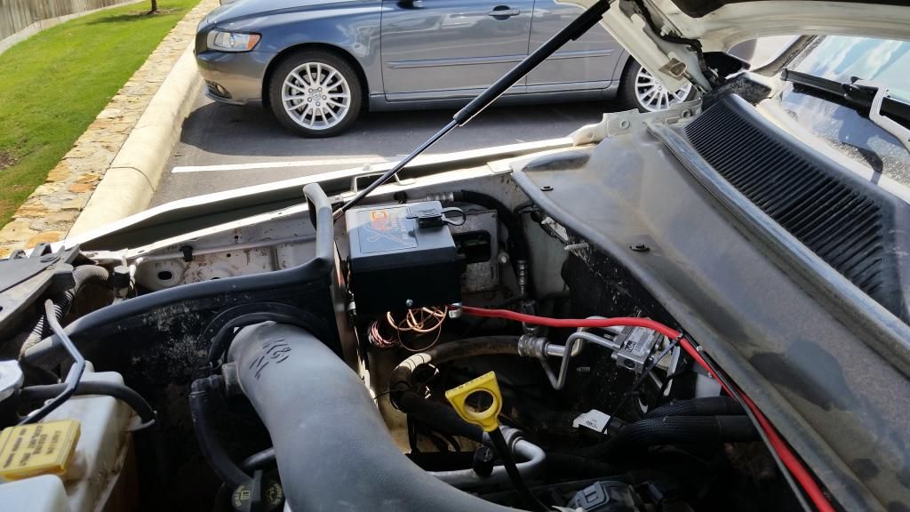

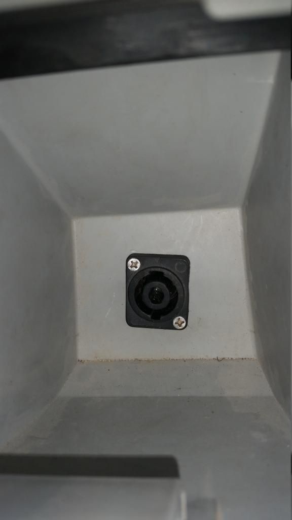

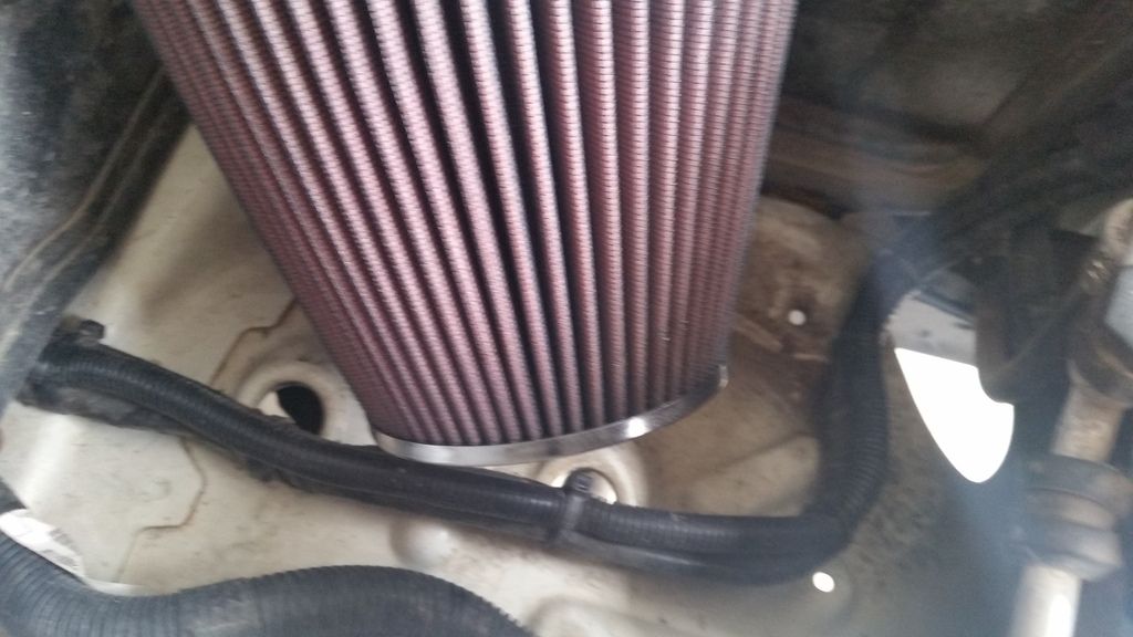

I was cleaning up under the hood and wiping everything down today, and figured I'd take some pictures of the winch to solenoid run.
Up the back of the grill by the headlight
Up through the hold for the air intake
The inside of the air intake hole
Tucked in loom and run across the air intake area.
Solenoid box screwed to the back of the CAI firewall.
Solenoid with the cover off. I figure it is up high enough that if it gets ruined due to water with that cover on, I will have much more serious problems than the solenoid.
