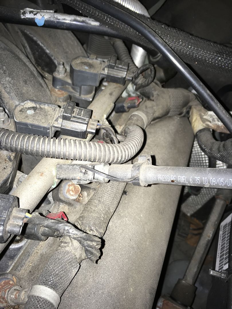

Checked fuel line from gas tank, no obvious leaks/ stains or smells, Checked engine compartment, Right rail connection from the line looks like leakage.
I'm wondering why there isn't a smell that I can tell when I'm in the city with Ac/ Heater. I even tried to get a whiff near the apparent problem and I couldn't smell anything. Was it just dumping gas when I was idling to warm it up?

From your photo it looks like the problem could be the connection from the rubber fuel delivery hose, rather than the metal fuel rail itself. Can't totally see that connection because something is in the way, but a cracked rubber gasket at the connection point is more likely than a cracked metal fuel rail, IMO. Should also be cheaper to fix too.

Thanks for suggestions, Here is a better picture.
Pahoward, any suggestions for safe sealants? Think I may lean on the safe side and just replace the connector?
Think I may just grab a new connector for the fuel line to rail to start.

I went out to my Jeep to check, and confirmed my suspicions. You are missing some sort of clip that holds the high pressure hose tight onto the fuel rail junction. It's not a very good photo because I took it in the dark, but...

:BINGO:
Wonder if I can grab a new clip or if I'll need to redo the connector.

Lfh, not sure if its an 08 KK thing but mine doesn't have that either.
OP, idle the jeep and look for the seeping point. Replace part thats seaping. If it seaps right at the quick connect press it into the fuel rail. Still leaking, replace.

Its a bit hard to tell because of the steel mount for the rail just below, Seems to drip and pool there. I'm a bit worried its the rail itself.
Any idea where I can get the barbed connection piece that specific to the rail? I'm assuming there's o rings in there that go bad?

Just an update here, Removed it all between another connect in the engine bay running towards the rail.
Rail looks great! Replaced the hose and fitting and everything looks good. Probably wont know for sure until I start it again on a cold morning which wont be for awhile here in Phoenix.
