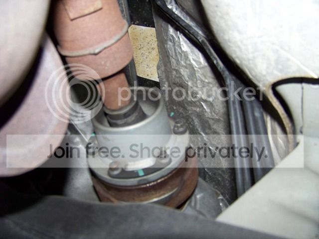

Check the front CV on the front drive shaft at the X-fer case. You should have little to no play in it, and the rubber boot should not be torn. Also no grease splatter visible in that area.

A good X-fer case CV should look like this.

Any chance you could snap a photo of the CV joint at the back of the front drive shaft where it connects to the transfer case, and post it here? Scar0 posted a pic of what a healthy joint should look like, but it will also help you find yours underneath the driver's side. The comparison would help us diagnose the issue. If it's blown I would typically expect to see that rubber boot in the center has disintegrated and grease has been slung everywhere around where it spins.
