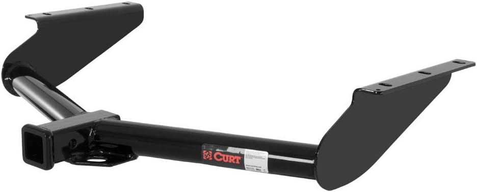

No matter the brand, it has to have the bend in it toward the rear of the vehicle to allow for non-interference of the spare tire.
See this install video:> https://images.etrailer.com/static/imag ... 13245.webm
Curt Trailer Hitch Receiver - Custom Fit - Class III - 2"
Item # 13245
or
Draw-Tite Max-Frame Trailer Hitch Receiver - Custom Fit - Class III - 2"
Item # 75578
This is a good place to compare hitches:> https://www.etrailer.com/hitch-2010_Jee ... -Class_III

That's the problem, it's a MULTI-Fit hitch and is not designed specifically for your vehicle.
It will work, but there are issues.
Reese Towpower 37042 Multi-Fit Trailer Hitch
The REESE Towpower class III multi-fit towing hitch is designed to fit popular sport utility vehicles, vans, light pickup trucks, and passenger cars.
You have two options, purchase the correct hitch designed specifically for your vehicle and sell the Reese, or find a good welding shop and let them modify what you have already installed.
