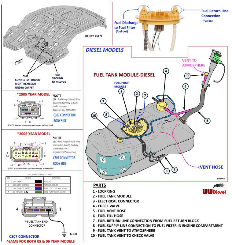

Hopefully this schematic drawing will help anyone planning to add an intank fuel pump to their Jeep CRD and want to add the two additional wires and terminals to their existing harness that are required without having to purchase the complete harness.

could you explain that, my sender in my 2006 is bad, so I was going to get this pump, did not know it needed more wring?
Airtex E7181M
20 year owner of Libby CRD!
 Post subject: Re: Adding Intank Fuel Pump wiring to connectors
PostPosted: Tue Jul 07, 2026 2:11 pm
Posts: 7437
Explanation:
If you currently have not upgraded by adding an intank fuel lift pump, you have to add two additional wires to provide (1) a 12v power supply and (2) a ground for the fuel pump in the wiring harness from under the rear seat C307 connector to the connection on the fuel module in the fuel tank module.
The drawings I posted shows the locations of the two additional wiring requirements for both connectors.
*Note: the ground wire for the fuel pump under the rear seat does not go into the connector, rather it is connected directly to a good clean body ground point.
The Jeep CRD came from the factory with all the necessary wiring, ECM logic, relay wiring, etc...for the intank fuel pump;
except they DID NOT provide/install the two additional wires in the wiring harness from the connector under the rear seat to the top of the fuel tank which must be added to install and operate an intank fuel pump.
If you have installed or had it installed in the past, all the necessary wiring for an intank fuel pump, then you do not have to add any more wiring.
Hope this answers your question?

WWDiesel wrote:
Explanation:
Thanks for all the help, I ordered the terminals, I am pretty sure it will be obvious once I take things apart, and no never had an in tank lift pump, just an inline under the hood. Been getting the Large fuel leak LHM lately, hopefully this and a new filter fixes everything up.

The great thing about installing an "INTANK" fuel pump is that it puts the entire fuel feed system to the CP3 injection pump under about 12-15 psig pressure so if there are any leaks anywhere, they will become self-evident very quickly as they will leak fuel out instead of allowing air to be sucked in.
Inline pumps are ok for a short time fix, but they still have the problem of if there is a leak anywhere between the inline fuel pump and the fuel tank, the inline fuel pump will still suck air into the system which is very BAD on the CP3 injection pump and on the injectors themselves.
FYI: The push on hose connections between the fuel tank and the metal lines on the body were designed to seal under pressure, not vacuum. Mopar should have never used them on these vehicles without an intank fuel pump. The push on hose fittings will seal just fine with an intank fuel pump as they will be under pressure instead of vacuum. The push on fittings are a carryover from the gas-powered vehicles that have a much higher pressure intank fuel pump.
Here is a website that details and walks you through all the steps to install the intank fuel pump and modify the wiring harness by adding the two additional wires into the connectors to power the fuel pump. It also shows you how to add the APEX terminals to the wire ends.
Airtex E7181M In-tank Lift Pump
2005 Jeep Liberty CRD (very similar for 2006)
https://www.auerbach.ca/kj/lift_pump/default.html

Wire Terminals Information:
Aptiv APEX (formerly Delphi) 2.8 Series Terminals 16 AWG to 14 AWG Bulk Automotive Connectors.
2 female and 1 male pins required & one 1/4" ring terminal for ground wire to body under rear seat.
Mouser Electronics, Inc.
Male, 14-16 gauge wire, Mouser Part #829-10757692-L
https://www.mouser.com/c/connectors/aut ... 10757692-L
Female, 14-16 gauge wire Mouser Part # 829-15509075-L

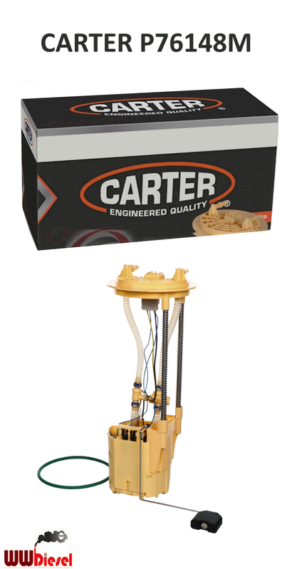

As to intank pumps*, these are the only ones I recommend for the upgrade:
Airtex E7181M
CARTER P76148M Most Recommended!
Delphi # FG1224
Mopar: 5143160AB or 52121447AD
*All of these modules should be available and easily sourced online for purchase.
The electric, in-tank low pressure fuel pump module assembly recommended for use in the Jeep Liberty CRD fuel tank upgrade was originally used in the 2005–2009 Dodge Ram 2500 and 3500 trucks (with the 5.9L and 6.7L diesel engines). It serves as a complete replacement module featuring the fuel pump, housing, and fuel level sending unit. It does require the reuse of the OEM fuel module's fuel level float arm due to differences in arm geometry. It also requires the adding of two additional wires to supply power & ground to the intank fuel pump, from an under the rear seat connector to the top of the fuel tank to the new intank module's connection plug.
