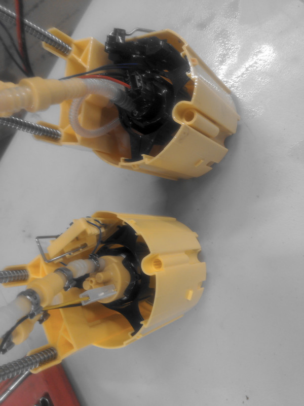

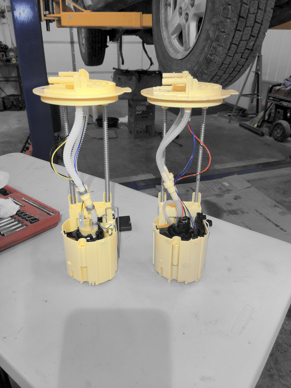

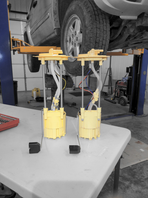

So got the deed done, but before pulled the pump with the tank down on the floor, I connected a clear hose to the out put, connect 12V, and it pump just fine, for the 1st half gallon, then it went to all foam, the tank still had 4" of fuel, just enough to not spill into the base. Well the A premium pump has the pick up screen vertical, and it has the potential to suck air, once fuel cant spill into the little cup. I put in the Carter pump and did the same thing, it did have some foam but not solid foam, and you have to consider it is free pumping with no back pressure. I took some side by side pics, with the Carter on the left, and A premium on the right. You can see the Carter is a better design with clamps on the hoses, larger ID tubing, metal screws, and caps on the bypass, and a steel mesh strainer all the way to the bottom.
