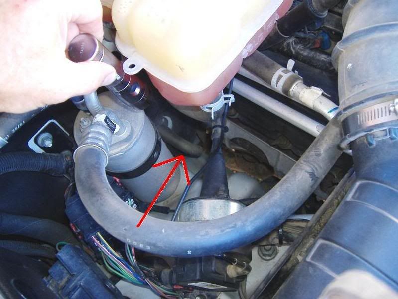

Thanks Ron. I have some RTV laying around somewhere, I'll use that. Here's an odd coincidence. Today as I was coming out of the hardware, I noticed a puddle under the KJ. My first thought was I'd done some damage to something during the lift, but then I remembered this discussion. Popped the hood, and there it was:
Water was dripping out, so I guess it's doing what it's supposed to do. :)
