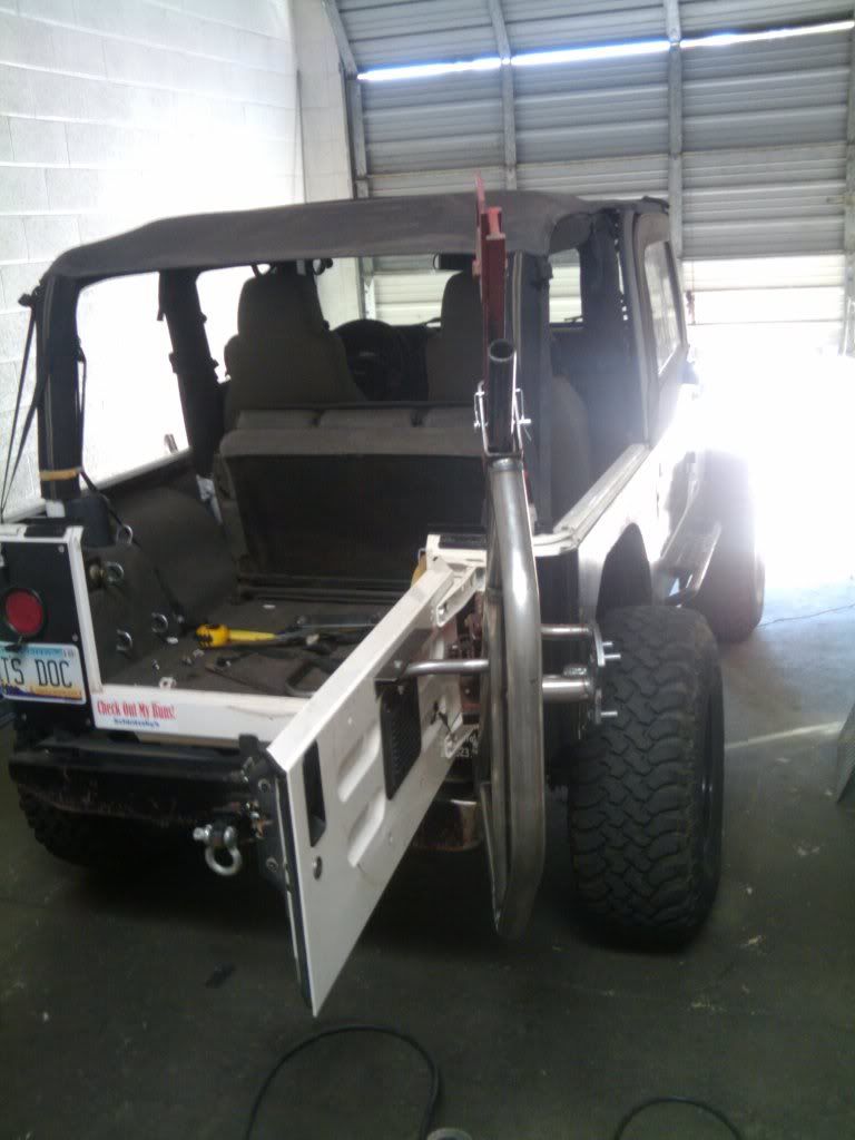

FreedomKJ wrote:
Here's an idea I've thought about many times but never really brought up…
Having a swing away tire carrier that you have to unlatch and open before opening the door seems to be a pain. How about building the tire carrier so the weight is carried by the bumper, like all other swing away tire carriers, but instead of a latch to hold it in place you attach an arm to the mounting location of the original tire mount on the rear door. Then when you open the door the tire carrier opens with it.
I've never seen one like that, but it seems to me it would be just a bit of simple geometry to get it working.
Here is one a local guy fabbed up that allows the carrier to swing with the tailgate - granted it is on a Wrangler but I'm sure the design could be adapted to fit ours:
Full thread here.

Thanks for posting that , neat design for sure, I had my tire off the other day opening and closing the gate trying to design/ draw up something similar.
