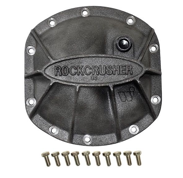

Rockcrusher makes a cover for the front KJ differential. I'm not sure how much more lube it holds over stock, but it might be something to consider for those who want extra oil. The OE engine skid plate already protects the front diff, so the benefit would mainly be the extra capacity. :2cents:
Has anyone confirmed whether or not this fits? Image
 Post subject: Re: Shopping for a new Diff Cover
PostPosted: Mon Nov 22, 2010 7:13 pm
Posts: 639
Location: Astoria, NY
Not sure that would fit the D30A housing. Rockcrusher website only list the D30 cover. Plus it would be covered by the engne skid, so you would never see the logo anyways...

For one I don't think there is much room to install one with the mounting bracket covering part of it
second , what are you going to do about venting it then?
Stock one works fine.
