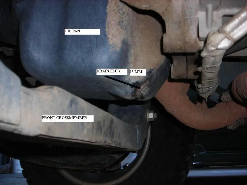

My owners manual never came in the Jeep. I recently bought a 2 ton floor jack with two 2 ton stands as well as that rolling bed for underneath but i dont know where to put the jack or the stands to get it up in the air high enough to change my own oil. any where to put them would be great aslo what oil filter i need, where its at, how much oil, best oil to use and where the nut is to drain it ohh one last thing is how big the nut is so i know what size i need? this is my first oil change by my self. Im generally clueless. pictures anything will help. Thanks!

Good spot for the jack stands. Look for the notch in the frame rail on both sides of the Jeep.
Looking from underneath the front bumper on the drivers side, you will see the filter. It might be other colors, but I think the factory filter is black.
Drain plug on the oil pan. It is 13mm and you can use a socket or wrench.
The cross member is a good place to lift the vehicle from w/ your floor jack. The above pic shows it fom the back side. NOTE: These pics taken w/ no skids in place. You might have a front suspension skid.
Best place for oil, filters, etc..... 5 qts. 5W-30 and a EAO34 (Amsoil filter) or Wix 51516
PLMK if you have any other questions! :wink:

Good luck with the oil change, especially the filter. If you have the skid plates, not shown in JJ's picture, you can still jack it up at the crossmember. That's where the tranny and engine skid bolt into. You also won't need to remove the skid plates since there are holes for the oil to drain through.
