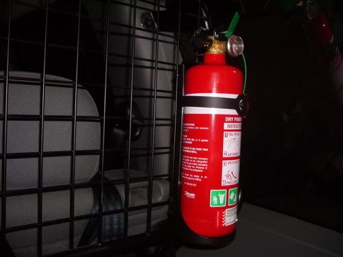

I bought a fire extinguisher for the KJ & have mounted it in the back on the luggage barrier. Has anyone else put in there KJ, perhaps in a better position. I used 4 cable ties & it wont budge :D , and as I wasn't sure where to bolt it I put it there. If you have any ideas of a better spot or where I can safetly bolt it + pic's of your set up, that would be great.

don't really have any experience in mounting one in a KJ but I wouldn't think that would be the best spot for it. What if you need to get to it quick you have to get out and go all the way around to get it. What if your backed up somewhere that for some reason you can't get the gate open? Then what do you do?
I don't know how big your extinguisher is but there's a small space under the drivers side seat will it fit there?
I'm sure in most normal situations you'll never need it or maybe helping someone else out or it's not a life threatning fire and you've got plenty of time to get it, but for that ONE time that you really have to have it and you can't get to it I'd hate for it to be unaccesible.

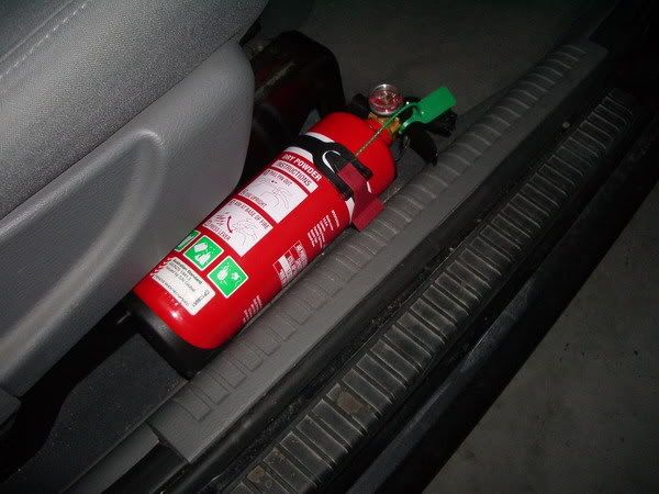

I couldn't get mine to fit under the driver's seat because of the elec motors but, it fit under the passenger seat pretty well...
This looks good, probably faster than where mine is now. I will re-think it tonight.

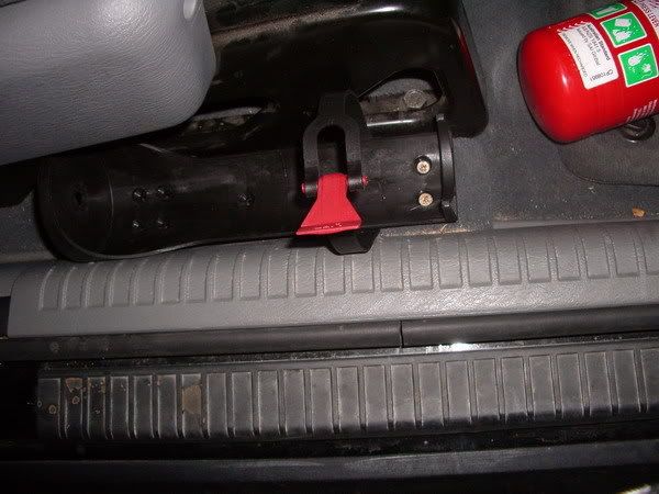

Moved it up front between the drivers seat mount's & the drivers door. I screwed the base of the mount into the plastic on the side where the door closes & used 2 screws & liquid nails into the carpet on the floor. Seems tight enough to me.
