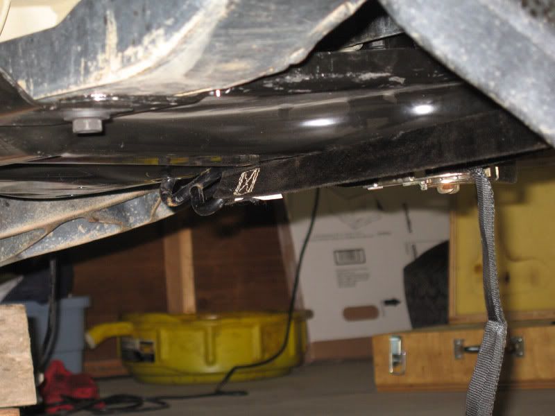

I am installing my lift next weekend. How do you use the ratchet strap?

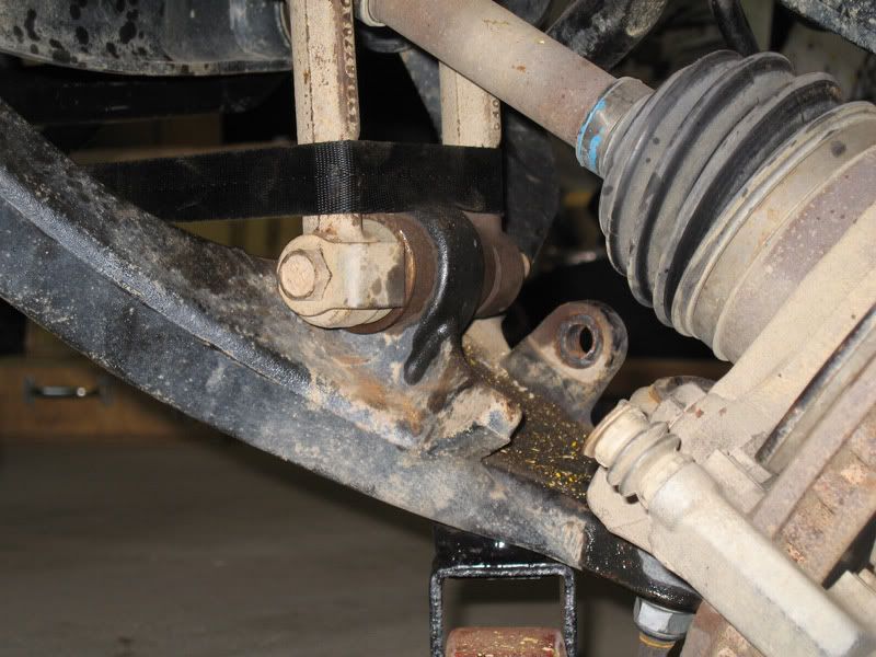

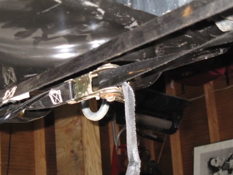

This is how you do it dude!
This is not my pictures or my work. I used this EXACT picture to do mine and it was AWSOME. You will find a few holes on your front skid plate. This works very well.
You will need 2 people and also good idea to use a 2nd floor jack. It will get hard and you will feel pressure, this is why we used a 2nd jack stand.
Take your time and it will work. It took me 5 mins to get it done.
