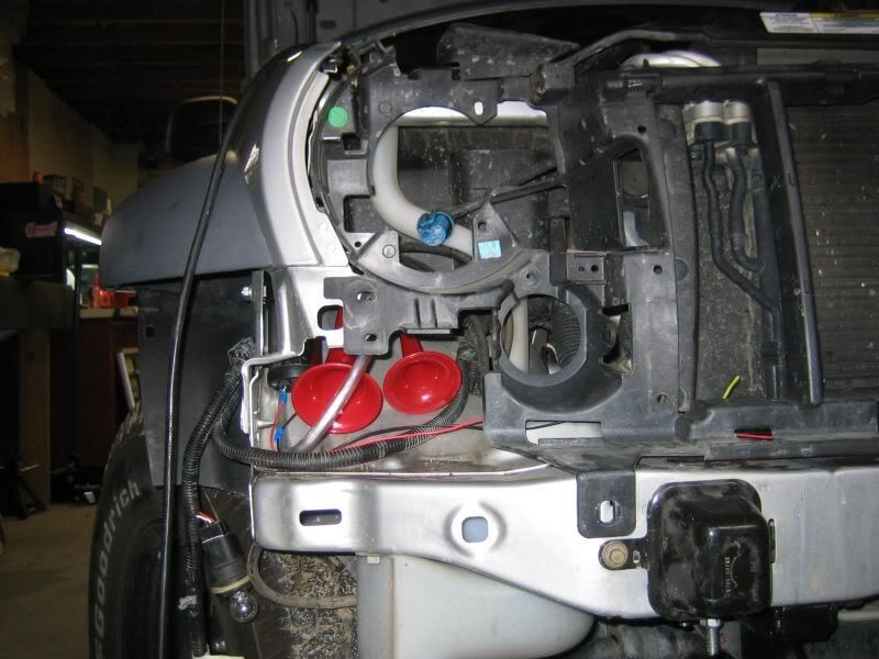

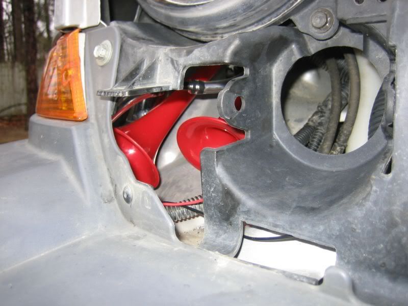

So I went ahead and picked up some air hours the other day when I was at pep boys. Cheap and I have been wanting them for a bit now. And Man are these things LOUD!!!! I got the two trumpet set up with the little mini compressor, they are about an 8" trumpet and 10" trumpet. I wired them in place of my stock horn. I just cut the wires leading to the stock horn and ran new wires to the compressor for the trumpets and wallaa.

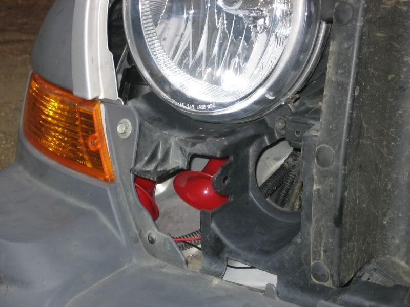

I mounted them and the front side/ top of the wheel well under the passenger side. You can't even see them with everything put back together! But you can definitely hear em!
With the grill back on you can't even see them.

dang you had to take off the whole bumper to install them...way too much hassel for me. but those things scare the heck outta people. here comes the liberty train!
what is the long bolt i see below the crush tin? front hitch bolt?

It really isn't a pain at all to take the front bumper off. Plus I wanted them hidden. 4 bolts and a couple push pins. Then the plastice brace setup under the grill is about 5 bolts and the head light was two. Only took about an hour by myself. The long bolt your seein is the front of the M bolt for my tow hooks.
P.S I scared the shyt outta my wife when she came home!!! :shock: :lol:
