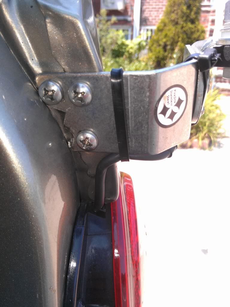

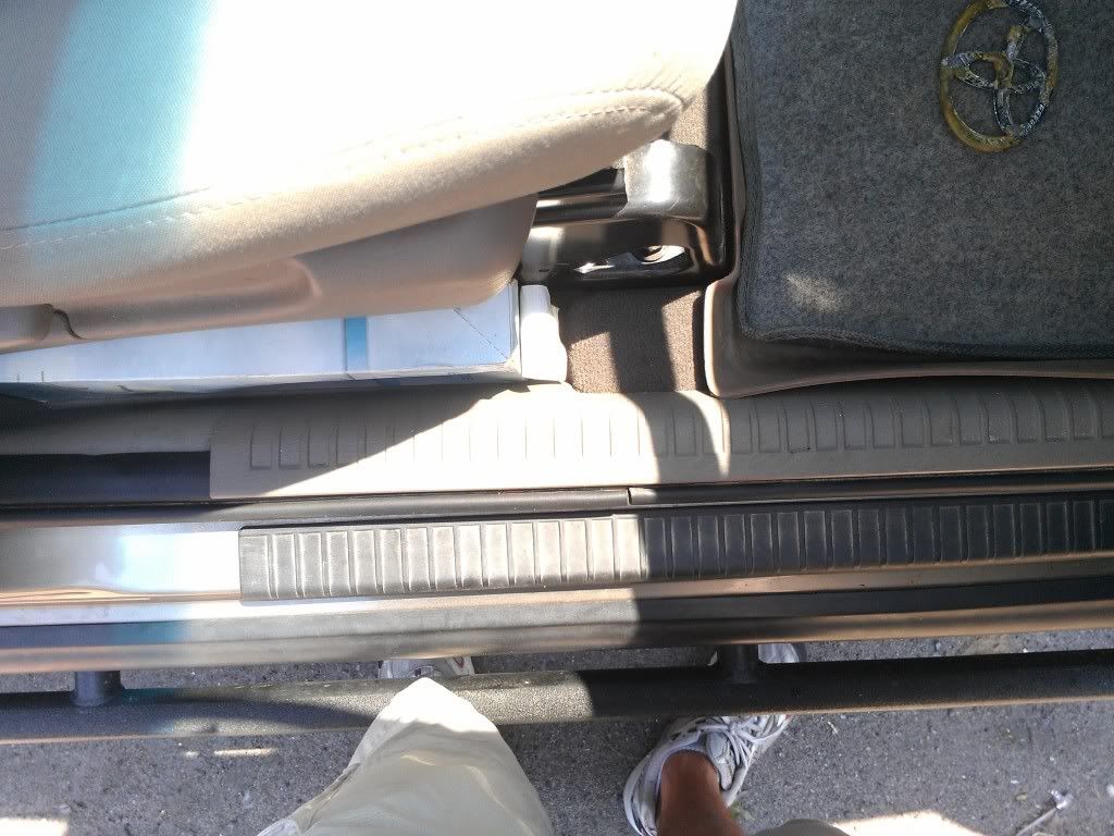

ok but where or how did you route the antenna cable?

under the plastic paneling that in next to your doors...just pull it up and route it through

I notched a little space in the tail light for the wire to pass by.
Behind the tail light, there is a hole in the body of the jeep that passes into the rear cargo area under the plastic.
Then I just ran it under the plastic trim on the passenger side.
Rear
Front

is the bracket screwed in or thru bolted? bracket is on order just seeing how you guys attached it

Self tapping screws, measure a couple of times, make sure it is level, then drill a small hole for each screw.
Like VMKJCRD, LI_KJ, and myself, we cut part of the bracket to fit, I only cut off the corner because I wanted to make sure it wasn't going anywhere, two screws are mighty strong, though.

ok wasnt sure if i needed to pull tail light out and thru bolt
