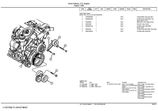

Does anyone know the part number for the pulley for the tensioner (#5 idler on the diagram)? Or do I need to replace the whole unit? It's whining really bad and I want to order the part tomorrow from the dealership.

So when you get a CRD?
That is the pic of the 2.8 CRD engine,not the 3.7 V6.

oops - I had the wrong pic :oops:
I changed it.

Get the whole new tensioner,Goddyear Gaterback makes a good one.
 Post subject: Re: Belt Tensioner Pulley
PostPosted: Thu Mar 18, 2010 5:51 pm
Posts: 1839
Location: Lost in Illinois
For the 3.7 only
Goodyear Gatorback Belt Tensioner Assy p/n 49246.
Goodyear Gatorback multi-groove serp belt p/n 4060875.
Goodyear Gatorback Idler (only) p/n 49001 (incase you just want the idler).
But I agree with tjkj2002 - Just get the whole assy, and consider replacing the belt while you're at it. You can always save the old belt for a emergency back-up.

Here's the correct picture for an 06 Liberty;
When the tensioner failed on my 04 Liberty the dealership replaced it along with the belt & water pump (gotta love those extended service warranties :D )
The Mopar part numbers are 53030958AE Tensioner, 53013905AA Belt.

Thanks for the part numbers - it was a 10 minute job this afternoon!

once you get one, you just relieve the tension on the belt, slip the belt out of the way, remove the one bolt that holds on the tensioner assembly and put on the new one
naturally it's recommended to put on a new belt
