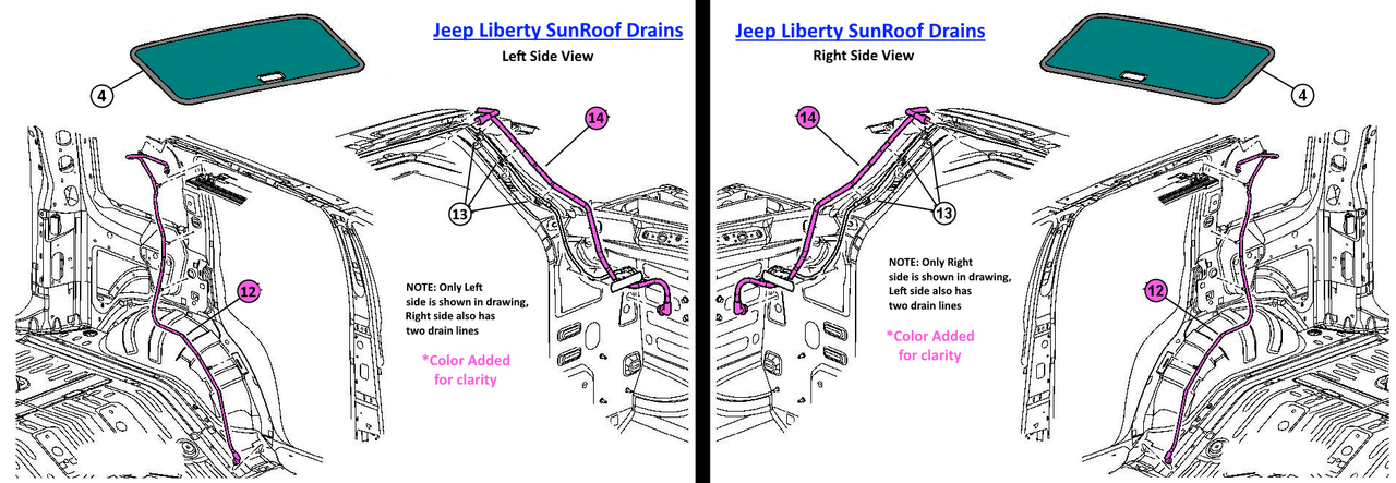

Does it have a Sunroof?
If so, there are four small drains, one each in each corner of the Sunroof opening that if they get stopped up, will allow water to drain into the cabin floor. See drawing
Most times, they can be blown out and cleaned out using compressed air with a nozzle.
I had to unstop mine with I first got my Jeep back in 2013; water was dripping into the left floor everytime we had a hard rain.

Thanks for the reply and input.
My Jeep does not have a sunroof.

If you have a sunroof, be sure all the drains are clear. (unstopped) There are four (4) of them, one at each corner.
But if you are getting wetness in the front floorboards, that is good sign of the front drains are stopped up. (been there done that)
If you open the sunroof, you can then find and blow compressed air through each of the drains to ensure they are not stopped up.
