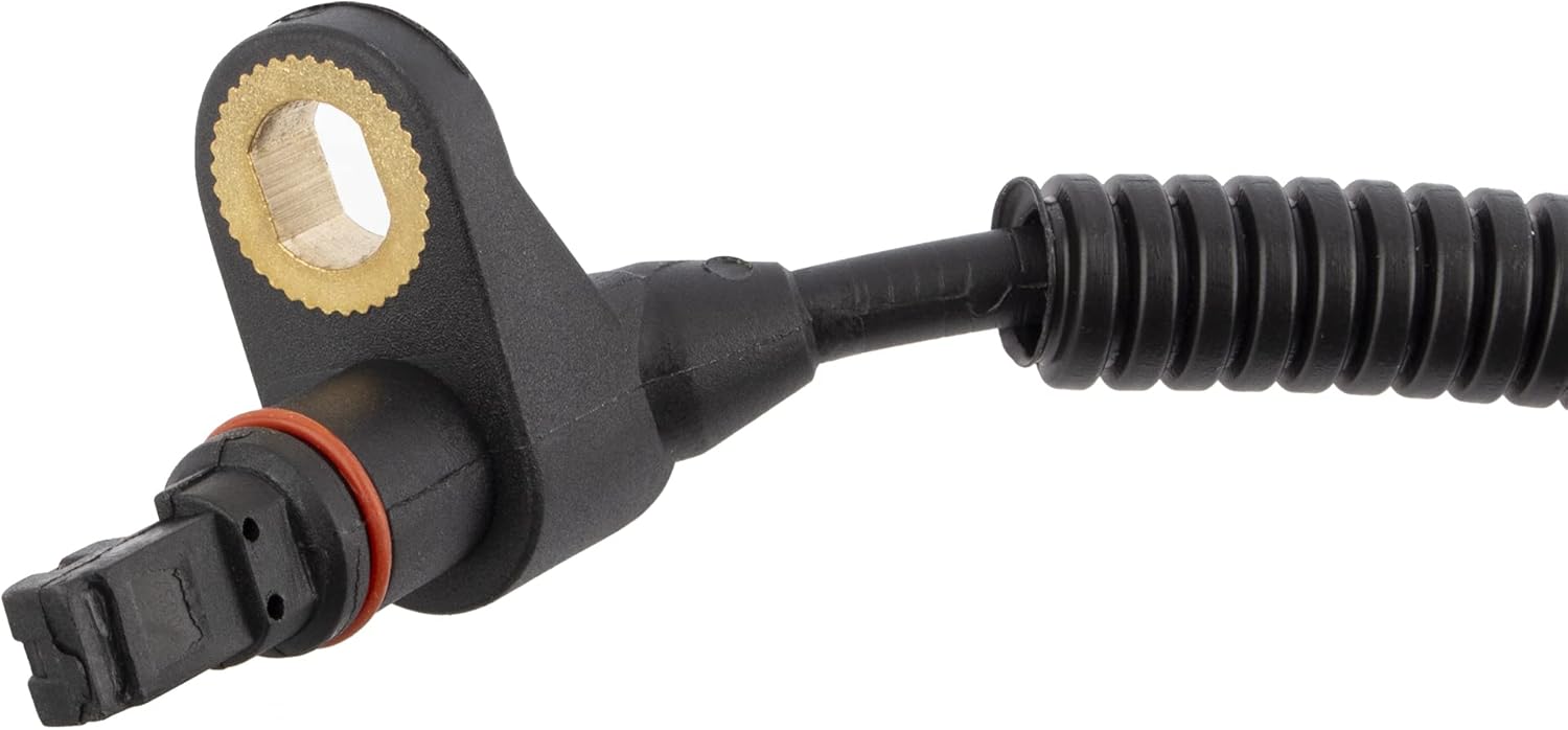

I'm back everyone! I'm told a software glitch was preventing me from posting. Thanks for the fix !!!
Attempted to purchase a new ABS sensor cable for the right front wheel. It has a square body to the sensor but the new part arrived with a round body. Anybody have experience in finding the correct square body sensor? Do I need to change my front knuckle to accept a rouind body sensor?
Both types of front ABS sensors. Square body for right wheel. (Round body is new part)
Front suspension with red arrow at knuckle
ABS sensor cables
Dean.

PostPosted: Mon Dec 09, 2024 10:08 pm
Posts: 561
Location: Australia
Probably a silly question but will the round one fit in the hole?
Australian KJ CRD 2006
PostPosted: Tue Dec 10, 2024 12:03 pm
Posts: 718
It only goes in as far as the o-ring, the hole is square into the remainder of the depth. I do wonder if I could drill it out to accept the round one.

PostPosted: Tue Dec 10, 2024 1:40 pm
Posts: 7366
The right front pictured on Amazon clearly shows a SQUARE shaped sensor. I would order the correct sensor and NOT drill out the hole to fit the wrong sensor.
Right Front OEM PN: 52128694AE or 52128694AF
https://www.amazon.com/BOXI-Passenger-C ... B09G6M93DH
PostPosted: Tue Dec 10, 2024 3:21 pm
Posts: 718
Thanks WWDiesel,
I ordered that ABS sensor from Amazon, I'll let you know what it looks like when it arrives.
Dean.

PostPosted: Wed Jan 08, 2025 10:46 pm
Posts: 718
Received the new AntiLock Brake cable yesterday and it looks like the right part. Yeah! :BANANA:

PostPosted: Mon Jan 13, 2025 5:47 pm
Posts: 718
ABS sensor cables
Dean.
Attempted to install the new ABS cable to the passenger side front wheel. The cable is the wrong part !! :banghead: I actually need the cable with the round end on it after all.
I don't understand how this happened. Last year I needed a CAT scan of my head and it proves there is a brain inside my head.
Thanks for the help WWDiesel for finding what I thought was the right part. Sorry I wasted your time and effort. I'll search Amazon and find the right part this time. I'm simply flabergasted. :oops:
Dean.

PostPosted: Mon Jan 13, 2025 11:28 pm
Posts: 7366
If you need further assistance, just let me know. :wink:
More than happy to help! :rockon:
Most of the ABS sensors I see listed online have the square end.
52128694AA Right Front ABS Sensor

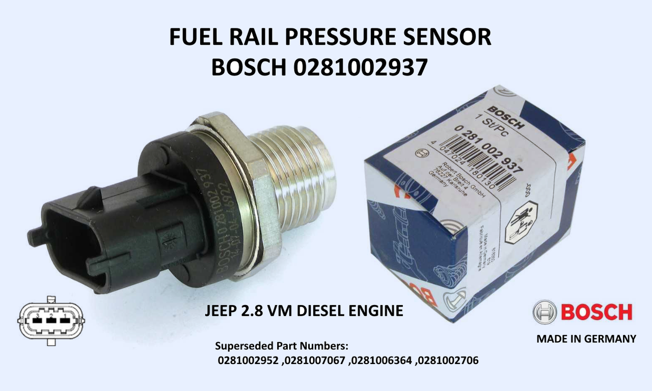

Hey everyone!
Who can tell me about the high pressure fuel pressure sensor? I've changed mine twice and the latest one only lasted about 100 miles. I see that IDParts carries Bosch brand, part number 0281006186 and charges $169. AutoZone carries one on the shelf for $617. There are other Bosch #0281006186 out there for only $25 - $35. Most of the cheap ones are made in China, etc., but how can I determine when they are from real Bosch manufacturers?
Any inside information out there?

PostPosted: Thu Sep 25, 2025 11:20 pm
Posts: 7366
What I have on file:
Google the part numbers, there are quite a few listed online, RockAuto lists the Mopar and GM ones.
They are all quite pricey, $100-$300+ dollar range. Cheap ones listed on eBay and elsewhere and are most likely chinese junk.
https://www.rockauto.com/en/moreinfo.ph ... 76&jsn=454
Fuel Pressure Sensor on side of fuel rail
Mopar: 5159963AA Replaced by 68020556AA
Bosch No.s: 0281002921 or 0281002534 or 0281002937
GM PN: 97361561
Cummins: #3949988
Replacement Connector: 05143781AB
GT7610-807
PostPosted: Fri Sep 26, 2025 3:20 am
Posts: 718
Thanks WWDiesel,
Your advice has always been right on target so I ordered this Rock Auto part without hesitation. Shipping was only $6 and will be here Oct 2nd.
