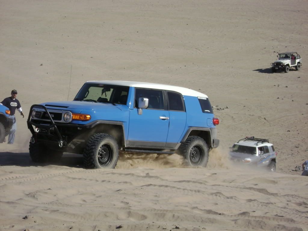

I have a few suggestions:
1.) Make the bumper allow for more ground clearance. Farther from the ground toward the tires and closer in the middle. Like ths FJ for example.
http://i155.photobucket.com/albums/s313 ... 1195102560
2.) Take some pictures farther away! I can't tell what the jeep looks like with it on.

The problem with what you are suggesting is it would expose all the things you need to protect Radiator,washer bottle,horns, This bumper is meant to be a bolt on not a change everything on the jeep.And us guys with a CRD dont have an option for moving the washer bottle without huge inconvinience so if what im gathering what you are saying correctly this
would not really work. :D
I will get some pics farther away though.

You know, even for us gassers, relocating the washer bottle results in about 1/2 the capacity. That's a real pain if you live where there's snow--dirty slush and water are always dirtying up your windshield, so you really need a good supply of washer fluid.
If your primary concern is ground clearance, I'd suggest a RL front bumper. In fact, there are a lot of scenarios where Marty's bumper is going to be better. But I'm only looking for "good enough" approach, and I like the idea of keeping my washer bottle where it is.

Oh gotcha, didn't even think of that. Thanks!
