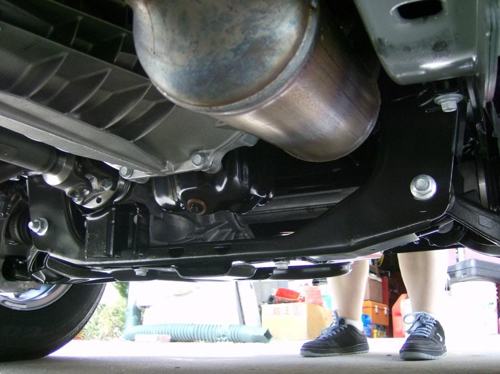

It was my understanding that the kk diff is quite different including the mounting from the kj
2002 Liberty, 3.7L auto, Franky
PostPosted: Tue Dec 30, 2008 11:48 pm
it has a hp diff. as far as the mount, looks the same to me
PostPosted: Wed Dec 31, 2008 12:04 am
Posts: 2787
Location: Jacksonville, FL
Dang that's clean under there! :shock: What's wrong with you? :roll:
