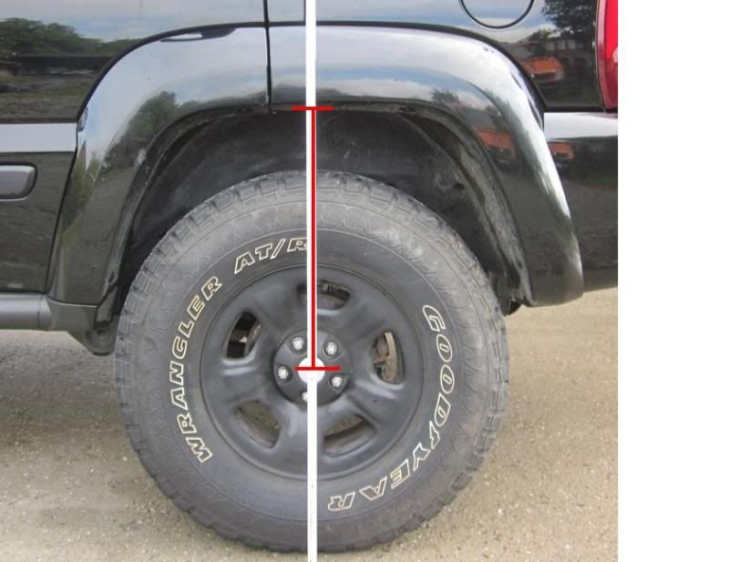

thanks for the pics, now I understand it a little bit better! Sorry, but I'm not am mechanics :-)
I have no problems on the front side, or what problem see you there?

With the size of tyres you are running you should have a LOT of rubbing against the pinc weld ( if it hasn't been fattend) and against the wheel arch. Do you experience that? Also do you have any banging noises when you front wheels go over bumps?
Also have you measures to see how high your lift actually is? Please can you, just out of curiosity.

the front side looks a bit sagged - lower than it needs to be to run those tires if you can get some conduit nuts - not sure what they'ed be called there but they're a common part for plumbing and what not, stack 3 together and tape them (not necessary but makes it easier) and use them for a gauge of how high your clevis is, you can put them over the shock can in the front and raise the front 3/4 of an inch which will help a bit

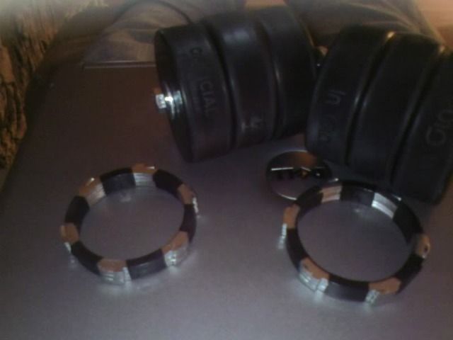

the rear isolators that were mentioned earlier look like this: (there's 4 of them taped together just for clarification)
if you are crafty you could make your own out of a big trucks mudflap - may actually be cheaper to do that compared to finding and buying stock rear isolators there
3 layers of the heavy rubber mudflap cut into the same shape as the stock isolator and put on first then put the stock iso on so it's the one in contact with the spring itself should be about right
the mudflaps i'm talking about are the kind you see on big Moog or Oshkosh industrial trucks - the mudflap itself is probably 3 foot long by 2 foot wide and probably an inch thick - i understand the issue of parts availability - you just have to make do with what you have or what you can get
all things considered, with a little tweaking you'll be alright
hope that helps you out some
as pippobug mentioned, beating the pinch weld down will help greatly behind the front wheels - there's also some spots infront of the front tires that get rubbed too near the fog light access doors - or where they'ed usually be if yours doesn't have them - usually can tell where it is due to it being scuffed or really shiny from the tire buffing it
you can soften the plastic and push it farther forward with a heat gun, or if you don't have a heat gun you can try gently warming the head of a big hammer and use that - or just cut it out of the way but I typically try to keep as much plastic shielding on as possible, makes the clean up after getting dirty a bit easier :)

sounds good, hope you don't mind i borrowed one of your pics and highlighted the measurement locations that we usually use to measure our four corners
thought a picture might clear up any questions related to the measuring

@JeepinJarhead03,
thanks for the pic, I measure the red line,
rear: 45cm
front: 46 cm
Oli

Then you're almost 10 Cm's lower then ours....so that's not a lift.

Actually surprised you can drive it at that height
if my calculations are right you're lower than stock height
yep no lift at all you're lowered :lol:
 Post subject: Re: new member - and questions to my new car with lift
PostPosted: Tue Oct 11, 2011 5:04 pm
17.7 and 18 inches is like, stock sagged - its about 5cm lower than fresh stock - give or take
I wonder of those Eibach coils are from the Eibach lowering kit for the KJ's
The previous owner or someone could have screwed up and ordered the wrong stuff at some point?
I think the Eibach lowering kit lowers it by 1.2-1.5 inches
I'm surprised it doesn't rub more than it does, i had 255-70-16s at that height and they rubbed pretty bad at about half lock when turning until i clearanced stuff out of the way - but I drove it like that for about 10k

Are you sure of you measurements?
poljot wrote:
@JeepinJarhead03,
rear: 45cm
front: 46 cm
I suggest you can get in contact with the following suppiers of Jeep suspention equipment in Germany and see if you can get a new set of Spring to lift your KJ:

I checked the measurements
front: 50cm
rear: 51cm
sorry for the wrong measurements, I took the first values from the photo, but this are now the correct values.

Even at those measurements you are less than an inch over stock height so not near enough to run that size of a tire without serious rub. Even adding a clevis lift and rear isos its going to rub
Most of the lifts we've done end up at least 57 cms to clear 245-75s just for comparison
