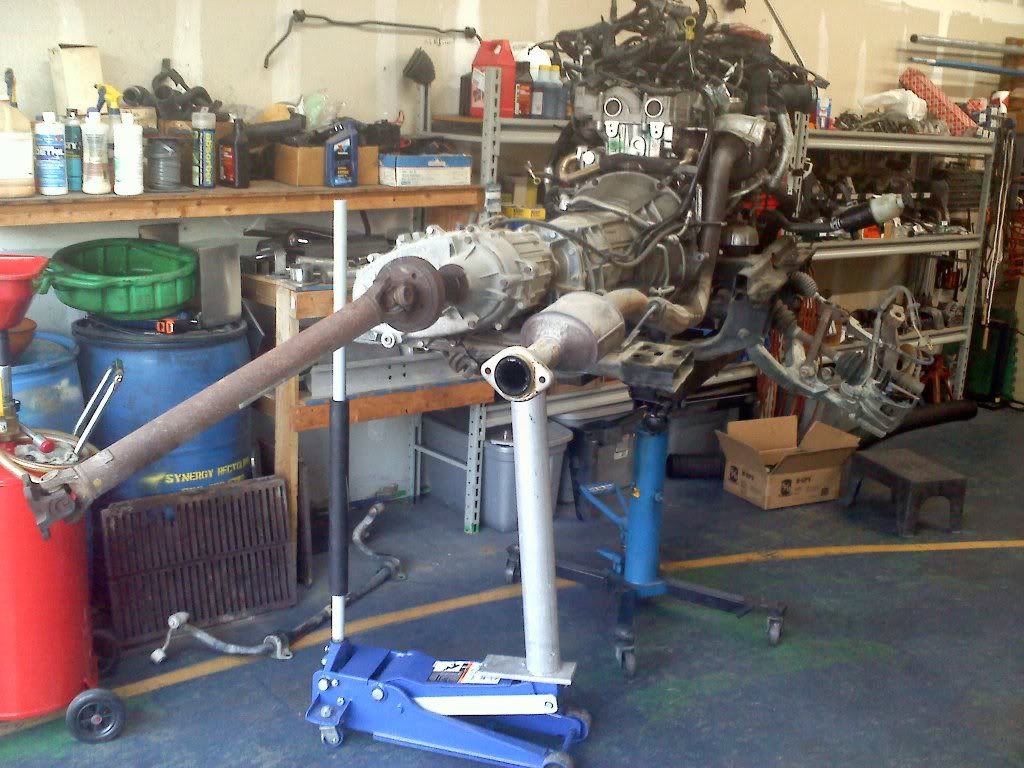

Well, the 3.7 is out and the 2.8 is finally bolted in. The 3.7 came straight out the front end, harness and all. But the CRD drive unit was dropped from the rollover onto an engine dolly and jack and wheeled out from under the carcass up on the lift. Then the 02 was lifted and the CRD drivetrain fitted from underneath. Everything pretty much bolted right up exit the transmission cross members were different, so a bit of fabrication was in order. Fortunately we were able to construct a custom "blended" cross member mount using both the 02 and 05 mounts. Now everything fits perfectly. The mod was pretty straightforward and only took about 30 minutes to get just right. Otherwise so far everything has been straight forward and going to plan.
Difference between the 02 and 05 transmission cross members:
http://s279.photobucket.com/albums/kk13 ... 040149.jpg
Custom transmission cross member mount made from 02 and 05 mounts. I would not have attempted this project if I didn't have my mechanic (the BEST independent in Florida without a doubt) available:
http://s279.photobucket.com/albums/kk13 ... 040156.jpg
Transmission with custom mount in place, fits like a GLOVE:
GBKJ2003, thanks for all your advice. We have already done/confirmed much of what you have said, so it is comforting to know we are on the right track at least. Hopefully tomorrow I will swap the rear ends, tank and lines while the expert gets all the wiring done. The 05 broken driver's lower control arm was swapped with the original 02 and it is identical, otherwise the whole drivetrain was swapped attached to the subframe as you suggested and it worked well, although moving it out on the makeshift dollys was a bit precarious and frightening (that is one HEAVY four cylinder):
http://s279.photobucket.com/albums/kk13 ... 172425.jpg

Thanks techman02, don't know why I can't post pics. The top trans cross member is from the 05 CRD, bottom is the 02 3.7. Middle pic is the "combined" 02/05 cross member mount my mechanic made from the 02 and 05 mounts. This was the only part we had to fabricate so far as the tranny cross members are the only differences we've encountered. Bottom pic is the CRD drivetrain on the "dolly" we rigged. Moving it was frightening as it was perched precariously. We moved it VERY slowly. Now the drivetrain is completely bolted in and the wiring harness is in place. Next is connecting the harness. Does anyone know if the 02 and 05 interior harnesses are different (window switches etc.)?

GBKJ2003, On the driver's side by the headlight area there is a large 10 wire (I think) connector on the harness. It appears that the pins on that connector are in different positions on the two harnesses, ie, like say 2 in the bottom left corner on one but on the top middle on the other, or something like that. I'll try to get a pic tomorrow. Did your connectors match? Did you just plug in that connector and did everything work as expected?
Also, on the 05 harness in that same area there are three loose wires (with plugs attached) hanging right next to that large connector. I imagine the connector was destroyed in the rollover. It seems like maybe a light of some kind, maybe a turn signal, but it is three wires. We can't find a corresponding three wire connector in the same area on the 02 harness. Any ideas?
I will probably just replace the 02 stock speakers with after markets, so I should be able to use the 02 interior body harness right, or are you saying the 05 main harness won't work with the 02 interior body harness? IOW, is the 05 interior body harness just needed for the Infinity speakers?
Happy New Year to you too, and all members!
Just one note for the record (for those following the steps). We did not swap the upper control arms and shocks, we left the 02's in place but swapped everything else on the subframe. I actually had to replace the upper control arms with new ones as the ball joint boots were all torn apart.
2002 Jeep Liberty CRD 2.8L diesel (perhaps unique in USA)

Yup, got the pedal assembly out and we did keep the original booster. Today we'll be swapping the 02 off the lift so the 05 CRD can go back on. Then we'll pull brake and fuel lines, tank, fuel receptacle and rear end. Had to keep the original washer bottle as the CRD one is larger and mounts differently to the chassis. Had to swap the connectors that is the only cutting we did on the harness. Cranked it over just for kicks and everything seems fine. Getting close :BANANA:
