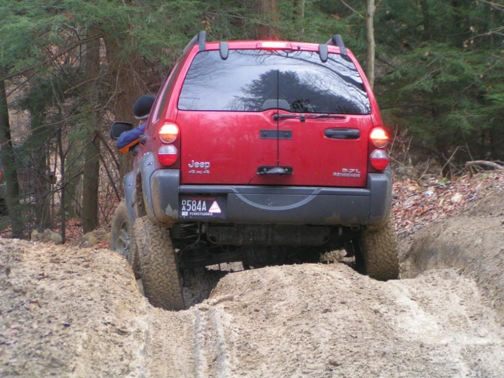

i have absolutely no complaints with my ESP i have to say it does it's job very well. Especially while offroading. if i'm on a very slippery surface where all tires have no traction the esp will spin one then both... then one. then both... then one.. then both trying to get traction. in a way it mimics having lockers. i have open diffs but there are a lot of times when all 4 of my wheels are spinning at once when none have traction. This is in 4 low (when the esp is supposed to be completely off). in 4 lo it does not cut out the throttle at all.. just helps with traction. when it's "on" in 4hi or 2hi it will cut the throttle/apple brakes when it feels a wheel slip. The only down fall is that it's not predictable. you never know when all 4 wheels are spinning and that only happens once your stuck. lockers are predictable.. and that's why i want them.

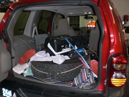

did they give you any more of a time period than this month? also where do you carry your spare? in the pics you have posted its not on the tailgate

all i got from them was that they COULD be in this friday (tomorrow).. and if not this friday than next. i'm ecstatic! now i just need to figured out if i want to do gears... and if i can swing the extra cash for gears. my spare is currently in my shed... i know not much use in there but i have a air compressor, slim, fix-a-flat, and a tire repair kit in my jeep.. plus only drive around here and we own a towing/bodyshop business. when i go wheeling i strap it down in the cargo compartment.. makes for a better departure angle (and yes i have hit it before when it was on).. gotta put the seats down to get it in there though i use the extra studs to mount my CB ant. so it doesnt keep getting knocked off the roof by trees
