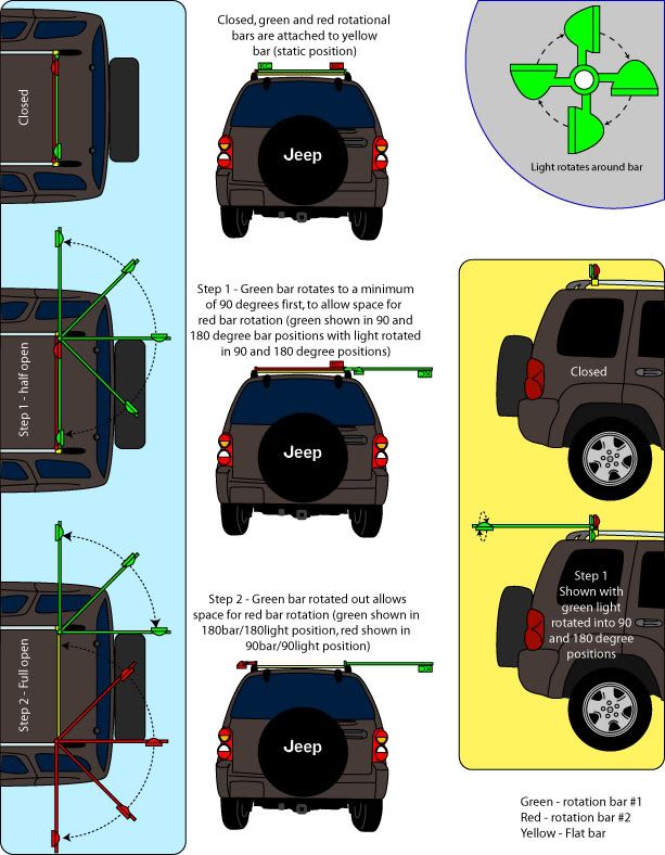

kkkustom wrote:
here is my 3rd grace CAD design! I am at work so this is the best I can do right now!
Wow, what software did you use to do that CAD design in? Man, it's slick, I could totally understand it, and the "Hand Drawn Rendition" is very realistic . . .

Freaky! kkkustom, if I'm following your brainstorm right, that's exactly what I've been designing! The structural limitations I'm coming up with are:
• Lights need to be placed in the middle of the rear (end of 2-foot bar opposite rotation point)
• No weight support in middle where lights need to be placed - Need strong locking mechanism to support both vertical weight and horizontal pressure (wind resistance created by lights while at speed is going to weigh more than the light being pulled down by gravity)
• Rotating mechanism needs to be seriously HD to withstand forces
• Attach method to rail/Jeep needs to be seriously HD to withstand forces
• Lights need to revolve around the rotating bar or they will point forward after being rotated out (this revolution capability will also be needed to point them down toward the hitch area). This comment is based on the lights revolving along the X plane (front-to-back method...bars stay parallel to the ground all the time). If the bar revolve along the Y plane (top-to-bottom...bars stay parallel to the rear of the vehicle all the time) the rotation of the lights would not need to revolve, but would also not reach back to point down at the hitch point.
If we can make it, it'll be AWESOME! But if it's not made entirely of really heavy duty materials, it's not going to last long. It won't be cheap, that's for sure.
You can also see (in the "open" picture) that the rear rail on my truck IS visible through the open rear window. You can see some light through that thing, but the severe angle that the light hits that tinted glass at really diminishishs the light's effectiveness. It's better than nothing, but you're better off with the rear glass closed.
And I can't wait to see the picts of the rail you made kkkustom!! Post 'em as soon as you get 'em!!!

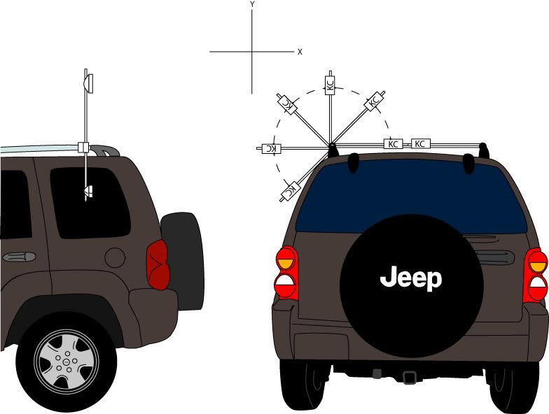

I'm going to draw this sliding railey thing up tonight or tomorrow. For now...this is Y axis pivot...not my favorite, but I had to draw it anyway to get a good look at it.

Dude you are on the right track too! I like your renderings too! between the both of us we gota come up with a winner! I am going to PM you... we gota chat some time!

ShadE - That thought crossed my mind more than a few times. It crosses my mind every time my thought process comes up against a design roadblock. But I have a blast finding ways to krawl over those roadblocks. Designing it is more fun for me than using it. :lol:
Catcher - I agree that rotating those Y-rotation bars beyond horizontal (180 degrees) would be bad. We'd lose light and bang the side of the truck. Bad bad bad! I agree completely, a flood light would definitely be more practical in the rear. I'm never going to be going in reverse fast enough to need light pointed 100 yards away. I need an even blanket of light in a 30 yard radius a lot more.
kkkustom - Thanks for the props on my drawings! I posted those completely expecting at least one flame because I whipped them out really quick. :-) I have a Master's degree in studio art and I've worked as a technical flat sketcher in the past. Anyway, it's the least I can contribute to the worthwhile cause that is LOST design and fabrication.
The new bars look K-A$$! If I had read your original design plans better and known that you were welding the bar to the brackets, I would have warned you about the stock rail taper.
I'll call you and we can brainstorm. But in the meantime...
I did some measuring and position testing last night (picture me standing in a dark driveway with an old broomstick, a flashlight, and a tape measure). I came to the conclusion (right around the same time that Catcher did...10PMish) that 1/2 width bar just isn't going to cut it. A 2' radius just isn't enough to provide the kinda light that we need from a design that we've been working on so much.
So I started brainstorming full bar rotation. I started with the Y-axis rotation, but quickly ran into a logistical problem. The depth of the light itself makes this concept incredibly complicated (at the very least) . When the bars are laid flat, the light(s) will overlap the other bar(s). Does that make sense? In other words, to rotate the first bar up and away, you'd have to move the second bar (at least the light on the second bar) out of the way first. But you can't move the second bar before you move the first bar, that's why I'm calling it "the first bar"...'cause it's gotta move first. So the resolution to this is to mount the lights in drastically fore and aft (of the center bar) alternating positions. Not the prettiest concept.
So I started thinking about the X-axis bar, which wasn't a big jump since it's admittedly my favorite design. With an approx 4' radius, the X-axis pivot design is almost perfect! Check it out...

dog_party, I gotta give you props . . . your sketches are quite nice and very illustrative. Unfortunately, I didn't have the time to illustrate what was in my mind much . . . but you've hit the nail on the head. That is exactly what I was thinking with one addition, I was not thinking of full length bars, but only half lenght with a solid bar for the re-inforcement and clamping ability when in the closed position.
As you have illustrated you have a much greater range of functionality with the X axis design.
And if it simplifies design any (maybe not) then the light need only rotate around the bar 180 degrees... to attain all of the useful angles.
And, with a little thought I think you could even set up the brackets, to which each light will mount, in a way that the lights line up and look very nice. Per your illustrations, the bracket on the red (inner) bar could positiont the light more forward to line up witht he bracket hold the light on the green (outer) bar.
I can hardly imagine the uses this setup would have . . .

Great ideas and fantastic drawings. An idea just occurred to me: what about mounting the lights on sliding rails, and just have the lights pivot on each end? Don't ask me to draw this because it'd look too funny if I did. Of course, sliders would not work in winter because they'd freeze up tight. Just a thought. Keep on designing, guys, and I'll keep on reading... :D
PostPosted: Fri Mar 03, 2006 11:50 am
Posts: 1979
Location: Lower NY
Dog party,
If ure gonna go with the rotating design, I have an idea for the light pivot end.
Instead of coming up with some type of clamp for the light to mount to which pivots, why not mount the light solidly to a normal light tab which is welded to a regular piece of tube, thus rigid. The key would be to have this tube slip inside of a second tube which would actually be the main light bar. Drill 2 holes directly through both bars so the holes line up and put a pin through this. Remove the pin, allow the light to flip down 180 degrees, the holes line up again and the pin goes back in. This would create a solid mount but still give ability to spin the light 180. Another advantage with this is that if u use that springy, curly sheathed wiring which expands (you know, like CB microphone wire) you could even pull the inner bar out entirely and use it for a handheld spotlight!
The pin could be replaced with a nut and bolt for added security. Placing a big rubber grommet on the tube that the light mounts to at the end nearest the light would then squish up against the outer tube adding some tension and keeping water out.
