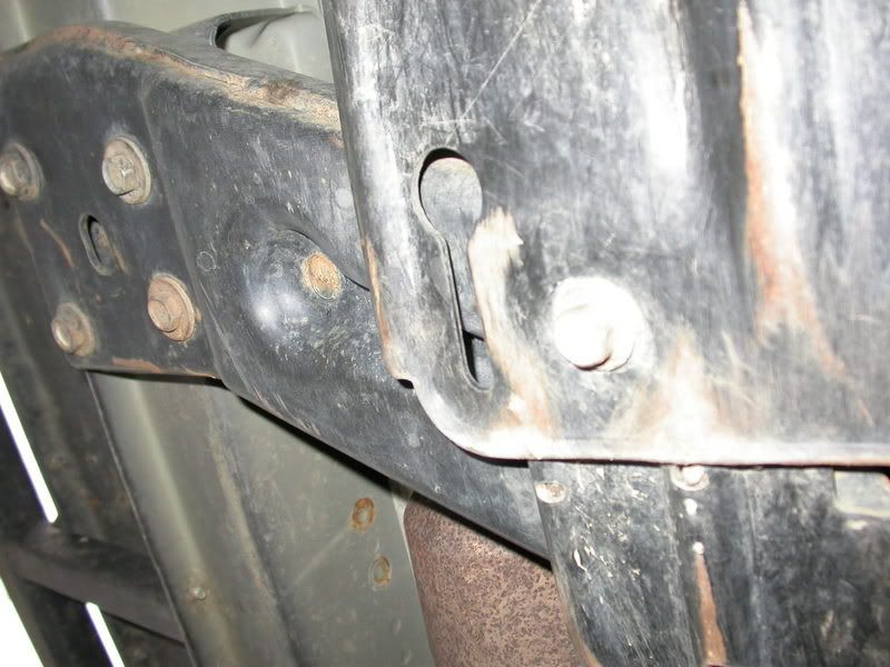

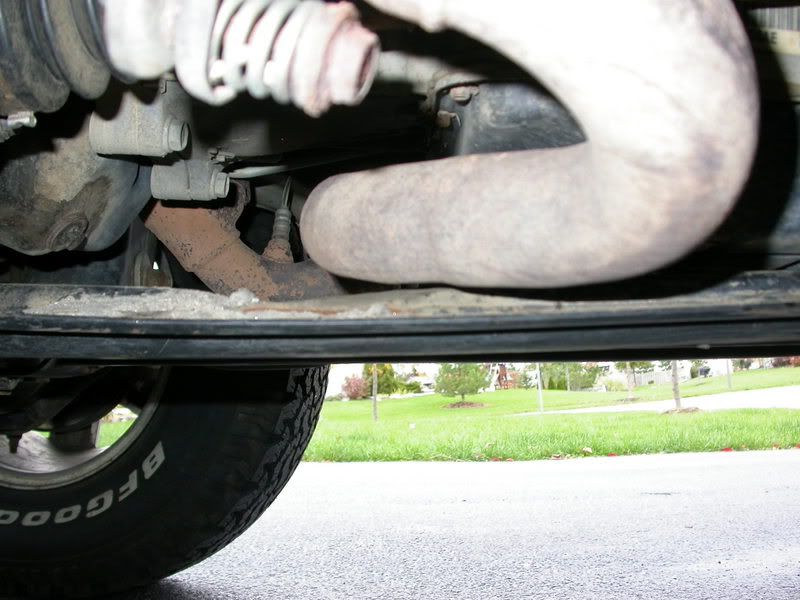

First install your transfer case skid. Leave the two front bolts out. Take the front of the tranny skid and tuck in under the engine skid. Only one bolt will line up, but that is ok. Look where the exhaust comes close to the skid and mark that area to pound down. If you don't it will bend into the exhaust and make noise.

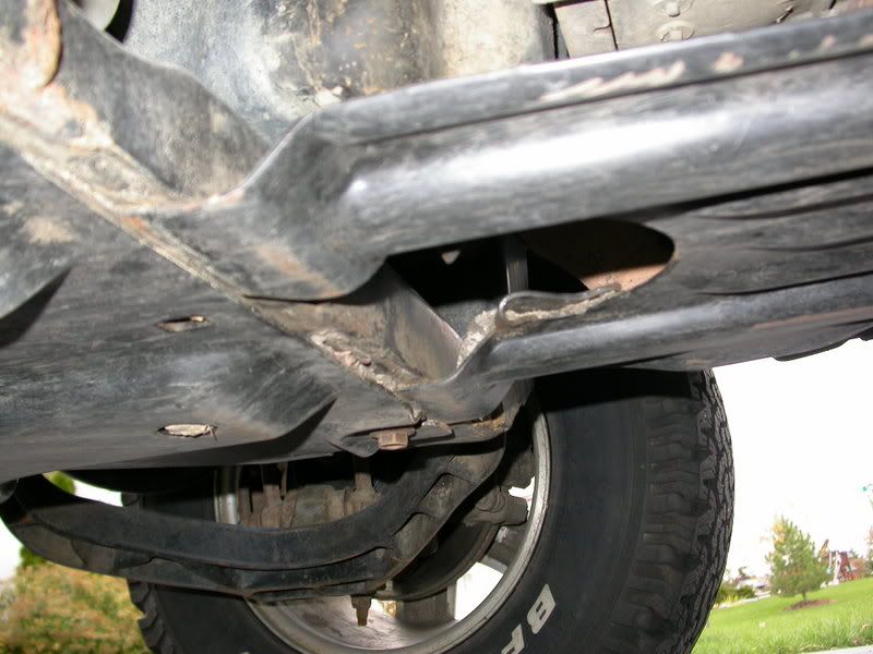

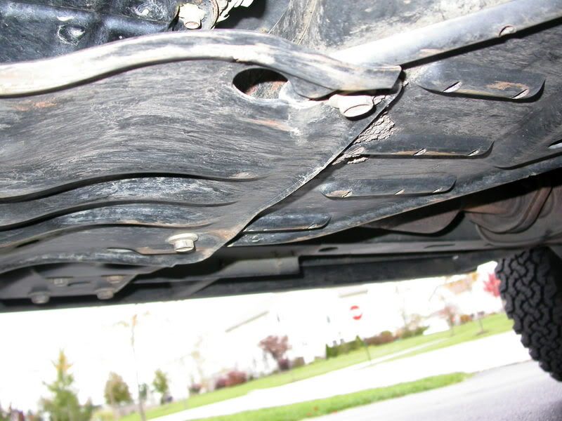

Then tuck the tranny skid under the lip of the transfer case skid. Put one bolt in and mark the tranny skid where you need to drill the other hole.
Pull the tranny skid off pound it, drill it, then reinstall, but this time make the tranny skid overlap the transfer case skid.

That's odd your's doesn't overlap. I'll take a look at mine when it stops raining. All my skids except the tranny were installed at the factory. As you can see in the photo the transfer case skid covers the entire crossmember, so the tranny skid has to overlap on mine.
