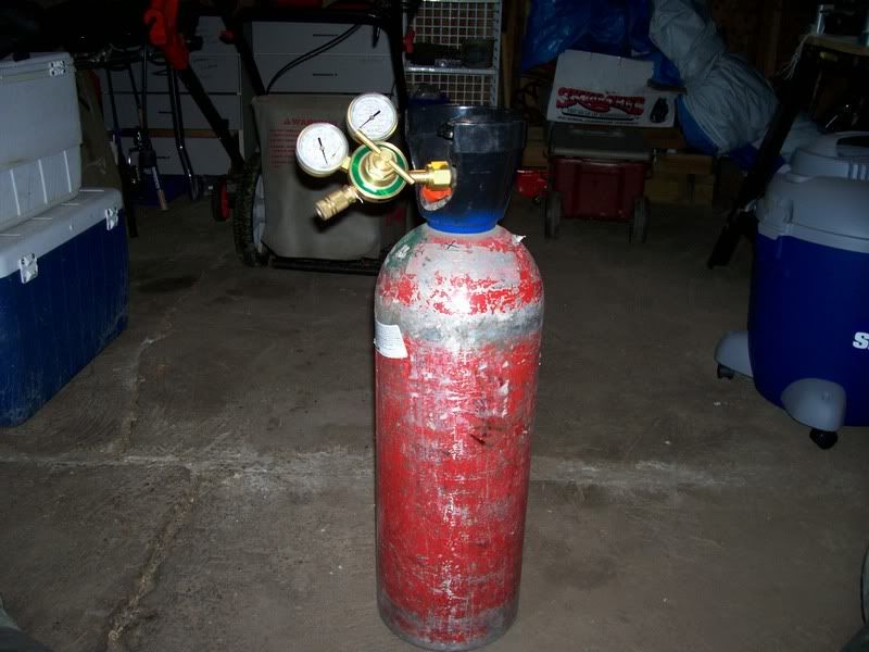

      as you requested

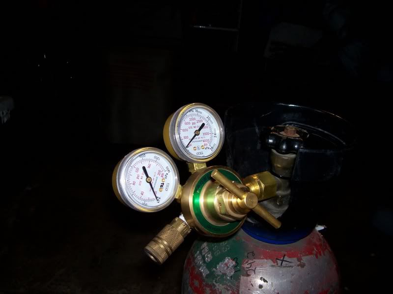

      here is the guage on the tank
      here is an up close of the guage
      It is not pretty but the price by far makes up for it
      My plan is to not keep the guage on the tank when transporting it but to put it on when needed
      I have a good paded carry bag for the guage so I am good there
