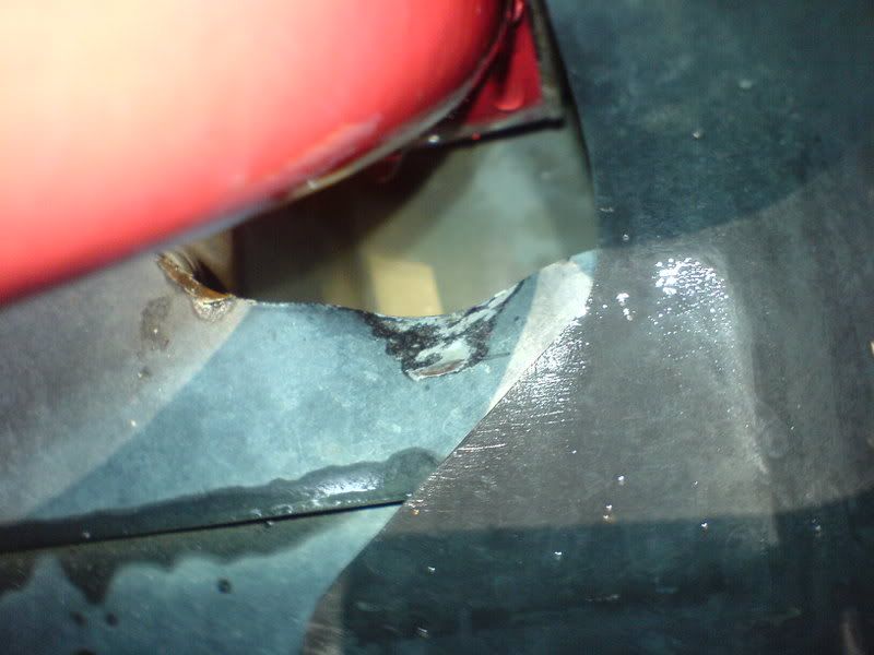

ok well i noticed this problem with Al's upper a arms and it does not look good at all... What do yall think?

Well, there was a page on jeepinbyal.com that showed how they suggested grinding out that pocket by .750 inches to allow the arm to have maximum travel up and down. But now when I click on the link to that page, the page is missing...
Heres a link to the UCA page that has the link to the missing page. Click on "pocket adjustments".
http://jeepinbyal.com/prod-Als_Upper_A_arms_for_02__07__lifted_Jeep_Liberty_s-2.aspx
-Jon-

Well thank you, but i sure wish that had been mentioned some where in the instructions...
Well, I think that was just recently added to the site, and now that its down, maybe that means that they found something wrong with doing that.
-Jon-

mine was doing that too.
Simple fix:
jack and support KJ
remove tires
remove castle nut from UCA
Push UCA up and zip tie to spring to keep it up and out of the way
Cut off extra metal with a sawzall
Cover bare metal with paint
Put KJ back together
Test extensively on rocky/muddy terrain (this is the most important part...DONT LEAVE OUT!!!!)
the metal is easy to cut, about 15 minutes per side to get it done.
Simple fix:
jack and support KJ
remove tires
haha nice tech write up!
